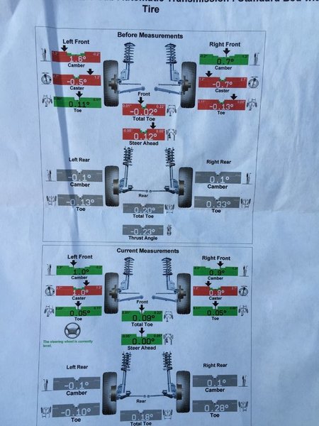

    Did you get an alignment sheet with the numbers?

    Hmmm, I'd try and get that number sheet from them if they still have it. They could've aligned your truck to OEM specs which aren't exactly what you want for a ~3" lift. Did you ask for specific numbers? Because if you didn't, again they probably aligned it to OEM specs and technically your truck is aligned correctly, but since your truck is lifted, your geometry isn't the same as it was before the lift and therefor you want different degrees of caster, camber, and toe so that your truck is aligned properly for it's current geometry. If that makes sense? :D

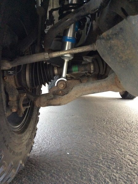

    Yeah that makes sense, I just didn't think it was possible to get it where it needs to be without aftermarket UCAs...but maybe it is? The alignment really isn't bad at all, I've just noticed some mild tracking issues and a bit of steering wheel shake. Do you think UCAs would fix this or should I go somewhere else to have it aligned? Keep in mind the front is lifted right around 3 inches...

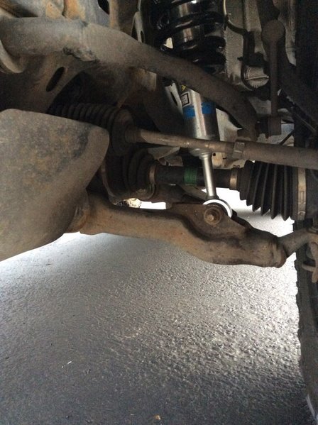

    I would probably get aftermarket UCA's just so your CV angles aren't so bad (I'm assuming they're being strained more than they should even though your alignment seems good). But maybe someone will chime in here as well. Maybe take a picture of you CV's?

    There's pics on pg 349 of this thread, lol! I knew I posted them on here somewhere, looks like I deleted them off my phone. Here they are again...image.jpgimage.jpg

    I was thinking they were pretty good....aren't they? Oz, are yours just really bad? Haha
