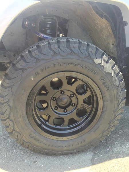

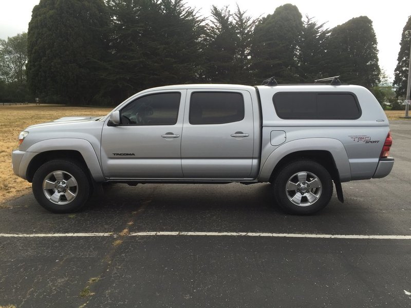

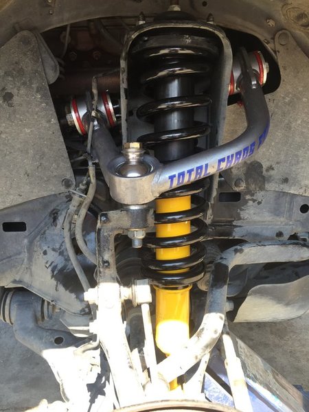

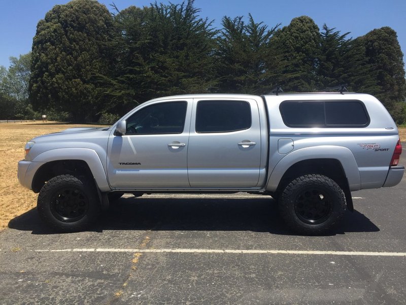

    image.jpg image.jpg image.jpg image.jpg Yes

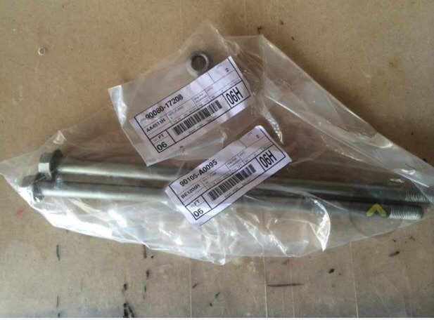

    Central Oregon
    For those of you that cut your UCA bolt where did you get a replacement bolt. What size, thread and any specific type metal? Thanks in advance.

    Front ARB bumper, LR UCA's, OME 885/90021 struts, Ome shocks rear, general springs HD leaf pack.
    Got mine from wheelers. They are the same for all newer tacomas

    392
    Why would you cut the UCA bolt? It doesn't take much to get it out. Channel-locks, some patience, and a buddy to help with the passenger side.
    Use a screwdriver from up top to pry on the bolt a little and punch it out). Took 15 minutes per side to remove.

    Yup, takes less time just to bend the inner fender in comparison to going to toyota to get a new bolt. After everything is re-installed, bend the fender back as close as you can; my dad and I sprayed some rust prevention stuff on it too.

    I didn't have any trouble with the drivers side but the passenger side no matter how much I bent mettle and punched on the bolt it wasn't comming out.. I replaced them just because I don't ever plan on taking them off again and wanted new clean bolts. I had to grind down one side of the head of the bolt to get it back in on the passenger side.

    I had the same problem with the passenger side. Had to grind the head to get the bolt out. Then put a new one in from the back.

    Front tow hook, bed tie downs, soon: OME lift, new tires, 17" Method Mesh wheels.
    I got mine at toyotapartznet
    Bolt # 90105-A-0095
    Nut # 90080-17208
    I figured it was easier to just cut them off than have to fight getting them out.
    Bolts were $9 each and nuts were $2.26
    I figured what's $25 when you just spent $1000+ on new suspension.

    I may try one more time. I tried when doing the lift. Started on the passenger side. Couldn't get it gave up for the day. Was beat from the heat.
    Thank You...
    Thanks for the link.
    Same as posted above may give it another try. Thanks for the reply.
    Will probably do the same. "Put new one in from back side"
    Thank you for the part numbers. Much appreciated.
