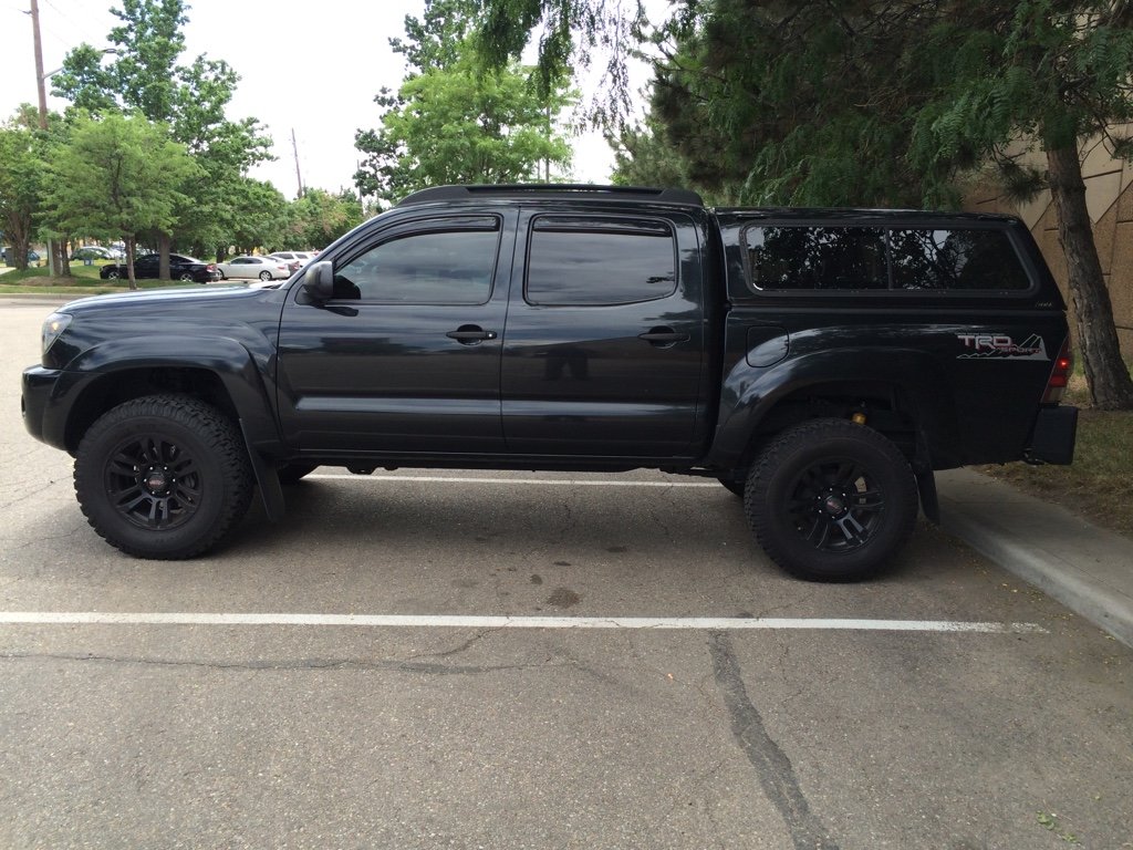

    So I've been slacking and still dont have any decent photos but I figure I will give a review since I am now aligned and have driven 50 miles on the new gear.
    886 coils are stiff, the front bumper and winch help it a lot but I am a little taken aback at how stiff the coils are. Its not a negative thing at all, in fact I think the truck tracks and drives much better. I also lost almost no lift in the front after added almost 200 pounds which is nice because I have a little bit of rake from the Dakars. The ride comfort is fine, I can is it being a bit taxing if the truck was a daily driver but over all I am very happy I went with the 886. I also installed LR UCA which given the amount of lift I got I think it really helped to align everything.
    The Dakars are awesome as well, they feel about as stiff as the front and gave me more lift then I had expected. Even with a topper, deck and tools the back is still a bit higher then the front. Its not enough to make me want to remove a leaf, once the dog and camping gear are in the back it'll level out nicely.
    Overall things are settling a bit, I am getting use to the difference in how the truck drives. I will say that I was kinda shocked at how much a 3"ish lift raised the truck. My girlfriend suddenly has a harder time getting in and out of the truck, it stands so much taller!
    Now its time for new tires and possible spacers!

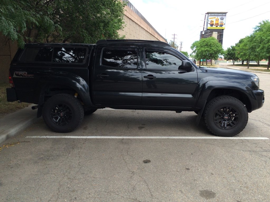

    10 DCSB sport
    884's out front 22.5"
    Dakar's out back 24.5"
    Measurements from center of hub to fender.
    Have lr uca's that i'll add at some point.
