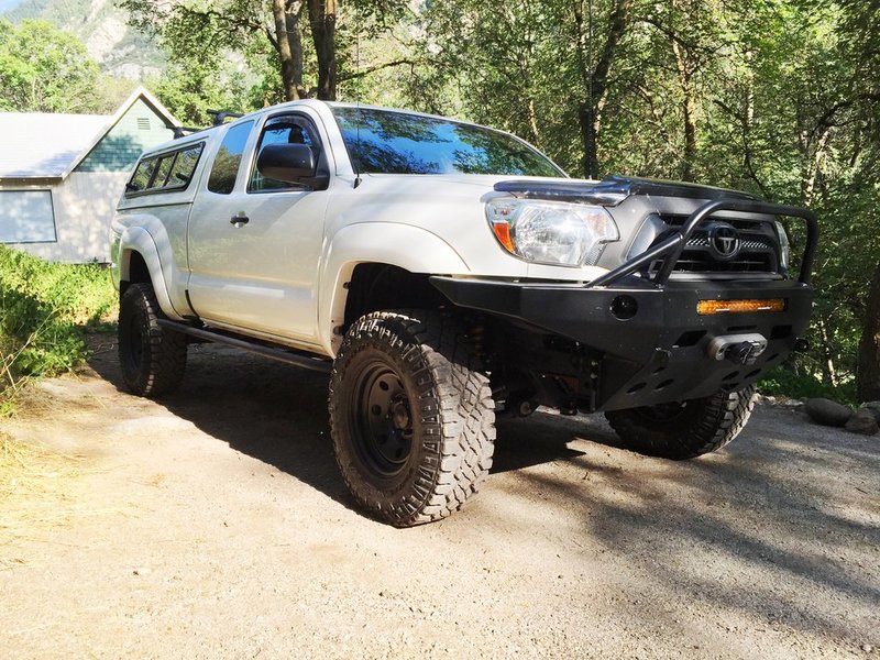

    Had a low speed vibe, ordered the OME diff drop and it drives GREAT. Now I need to chop my cab mount to fit the 33's at full stuff...
