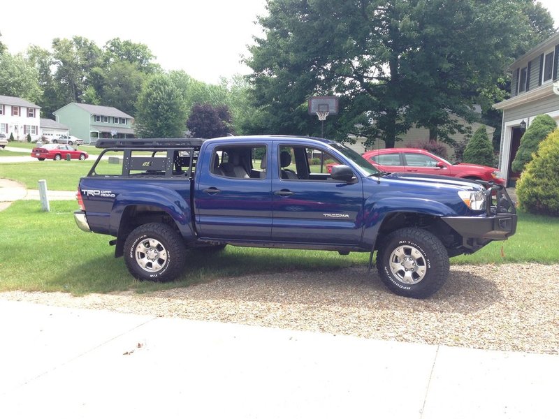

    What size tires do you have Frank? Truck looks really good!
