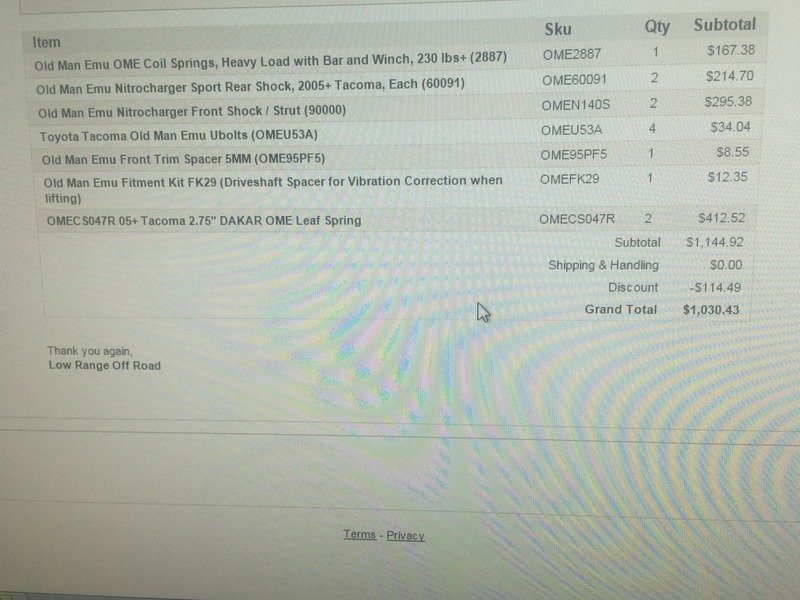

    No, coils were included in that price... Here is what I paid for everything.
    DCB4FB76-0C3F-471D-8DCF-6D75C735EFC3_zps_55e3381b5f537705168eec89ad5e70cae67dce33.jpg
    I pieced my components together because Low Range couldn't sub for 887 springs.
    And I just checked, Low Range is still offering free shipping on ARB/OME products... May be worth checking them out.

    Here's what I ordered from HS.
    OME Nitrocharger sport front struts part # 90021
    OME Nitrocharger sport rear shocks part # 60091
    OME trim packer part # 95pf5
    OME Dakar leaf packs
    Maxtrac extended length u-bolts
    Bushings and sleeves for shackle side of leaf pack
    OME carrier bearing drop bracket
    3-degree axle shims x 2
    Center pin head lengtheners x 2
    $1030.XX OTD
    I added 23” SS Kevlar reinforced rear brake lines, which brought me to $1089.XX OTD.

    Interesting how it shows the 90000 front struts in the description yet the sku indicates the older shocks which are cheaper. Just thought I'd point that out. Also did you get the OME ubolts (they are coated black)? This doesn't matter to the us, but for the company it means saving them some money hence allowing them to discount things further.

    Yeah, I thought the same thing about the front shocks. I ordered based on the sku because I wanted the older shocks. I was a little upset when 90000s were shipped to me, since I wanted the softer shock. Low Range's customer service was really good about swapping them out. They tried getting me the N140s but couldn't. So they sent me out a set of the 90021s instead, at no additional cost.
    They (or ARB) also sent me the wrong rears (60000s) and Low Range was quick to correct that as well.
    And yes, they were OME u-bolts. Not sure I follow as to how that saves Low Range any money though.

    The ubolts was more of an example, it obviously wouldn't be a lot the comp would save but everything adds up.
    As a retailer you could buy the OME branded unbolts and resale them or you could work with a manufacturer directly and have them made to the same spec and buy in bulk. That's how they would save, they would pay less for the ubolts yet sale them for the same price and include those in the kit vs the OME branded ones.
