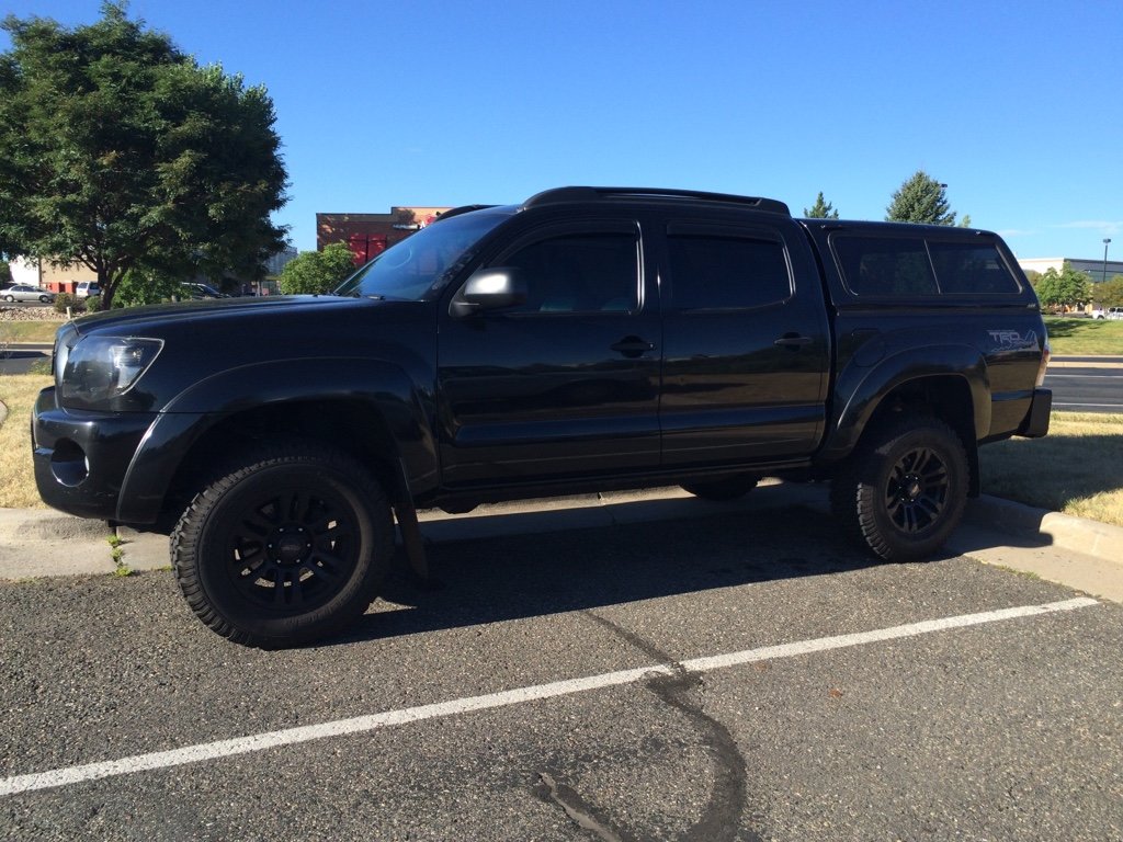

    Bought mine assembled. I'll take it out of the box and take a picture tonight

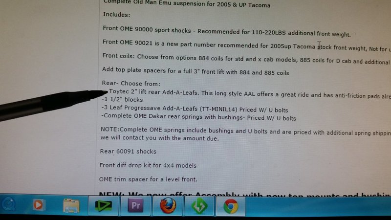

    Thanks thats helpful for a visual. So it can be installed in conjunction with top plate spacers.
    Does it have to be the OME trim packer part or would a shop putting in my lift have a comparable part that would work?
    I don't understand why OME doesn't tell you that you need this part for Tacomas to avoid the lean. When planning my lift I talked to ARB directly, toytec and wheelers and no one mentioned this.
    Sucks because it looks like I will have to do it at a later date unless shop has the part in stock by chance.

    Toytec and Wheelers include them with the assembled coils

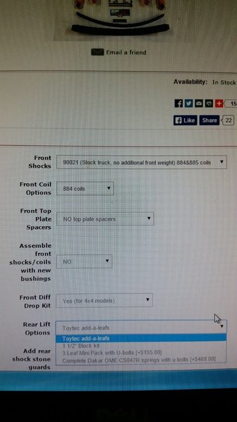

    got a few questions. i've tried searching, but couldn't really find the answers i was looking for as most of the trucks with this kit are double cabs/4 door. i'm gonna purchase the OME kit off of toytec later today and just wanted to be 100% before finalizing my order. any help is appreciated :thumbsup:.
    (2012, regular cab, 4x4, manual)
    1. will the 885's be too stiff or should i just go with the 884's? (i will not be adding any additional front weight)
    2. do i need extended break lines?
    3. do i need/ should i get the top plate spacers?

    How much lift are you trying to acheive ?

    2.5 maybe a full 3. are there any pros/cons to going full 3 inch? cv issues or what not?..?

    I doubt you're getting anywhere close to a 3" lift with just the 884s

    thanks! i think i'll go with 885's.

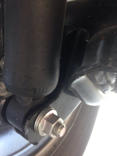

    So this is a pic of the rear shock mount on my 2015 SR5 4x4. Can Yall tell from this pic if the OME rear shocks will fit. Is this good enough to tell by?
    Thanks
  12. Aug 11, 2015 at 3:24 PM
    #7332
    Trent_G
    Trent_G Well-Known Member
    Apr 30, 2015
    #154287
    402
    Central Oregon
    I don't think you will really know till you put it on. Worst case you trim a little off shock mount.

    AFAIK it's a matter of about 1/8" which would be fairly hard to notice from a picture.

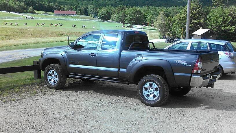

    Took a ride to the mountains this past weekend. 887s up front with dakars in the rear, sits just about level.
