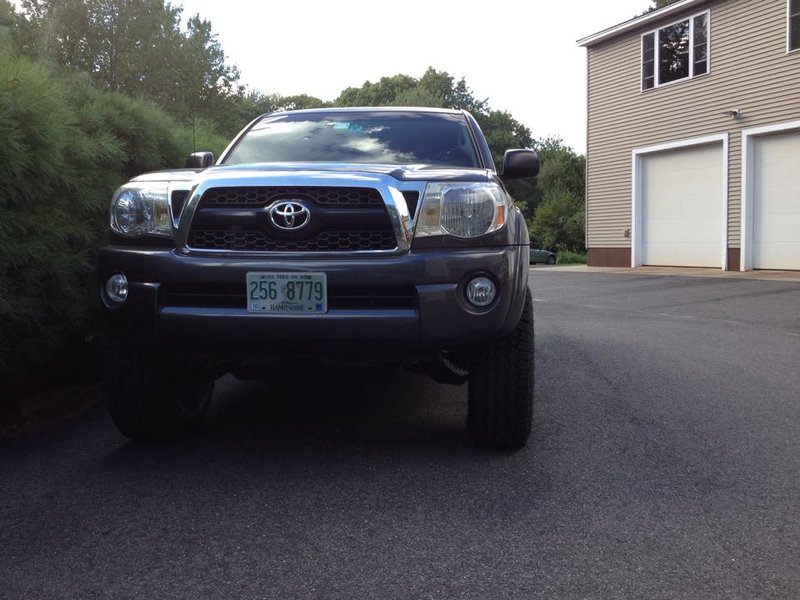

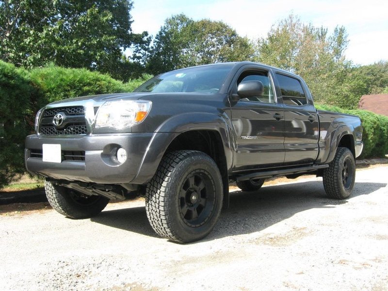

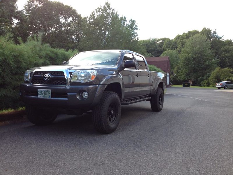

    Just picked up my truck yesterday after having my OME kit installed. Very happy with the look and ride. Haven't done hub to fender measurements after the lift but will tonight. Did not get trim packer in time for install. No obvious taco lean that I can see, but I will have to take measurements. Next on the agenda is getting a 285 spare to fit under the bed or get a tire carrier.
    OME 885 coils
    10mm Toytec top plate spacers
    90021 Sport Struts
    60091 Sport Shocks
    Driveline Spacer
    Dakars
    LR UCAs
    285/75/R16 Toyo Open Country AT II Tires
    Mickey Thompson Classic Wheels in Black 4.5 BS

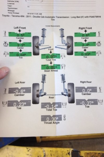

    Thanks Dr. Jekyll! Loving my Tacoma and will love it even more after I get this rubbing issue sorted out. Not sure why I'm rubbing with stock size tires - maybe due to the square shouldered BFG AT's? It's the most pronounced when I'm in reverse and full turn. The tire rubs inside of the mudflap pretty good and sounds like hell. Took it to a local alignment shop that specializes in lowered and lifted vehicles. On Monday, they're going to adjust upper balljoints on the LR UCA's to the +1.0 setting, and then re-do the alignment. As Oz-T pointed out, it looks like mine are currently set at +3.75 or +3.0. Will post pics and what the final setting ended up at. Worst case scenario there's still a little rubbing or I could just remove the mudflaps, which hopefully I won't have to do.
