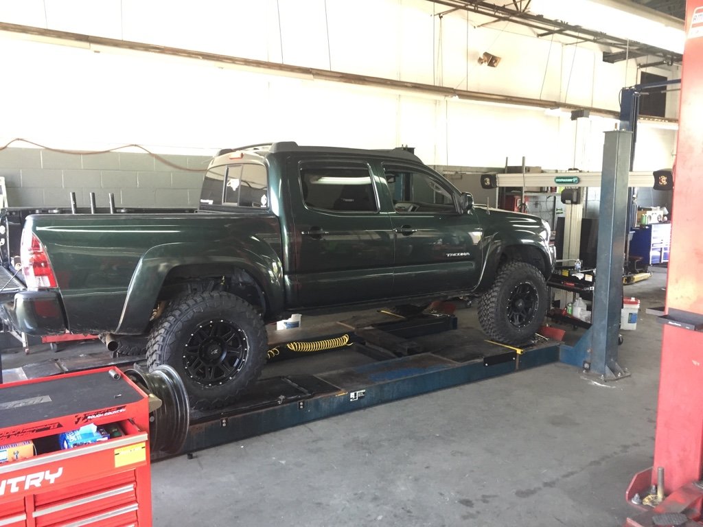

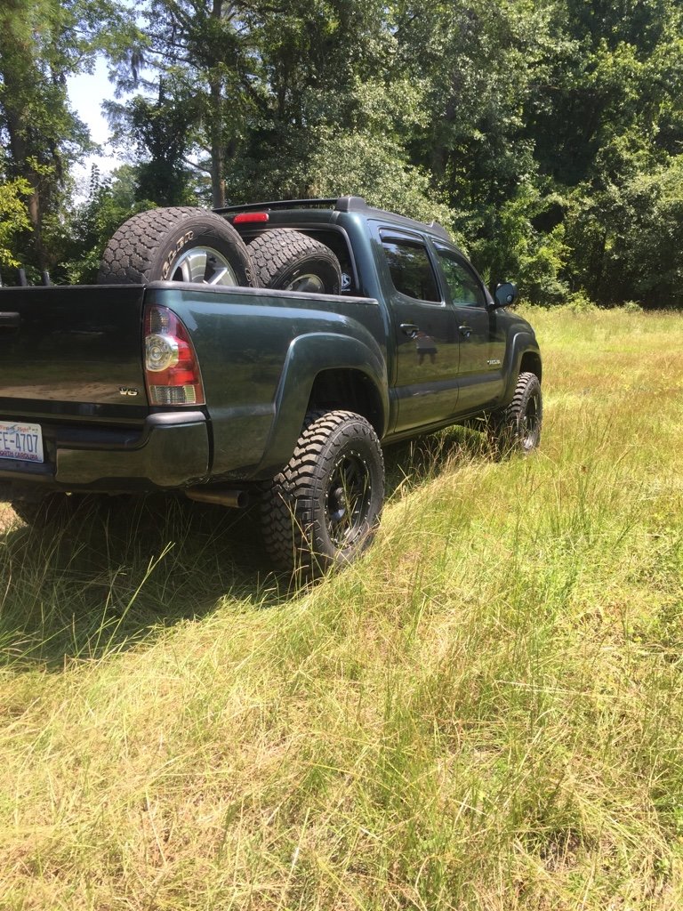

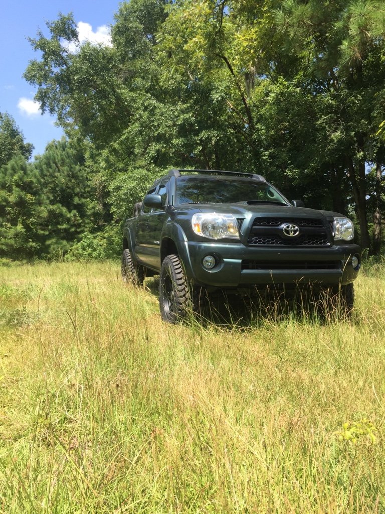

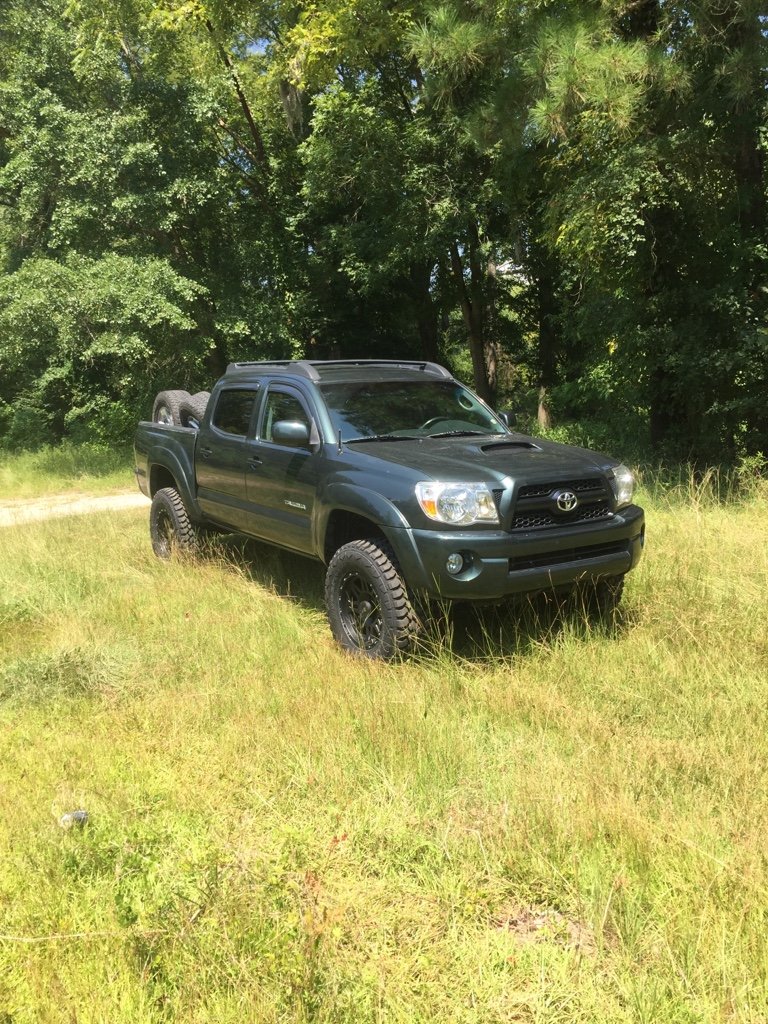

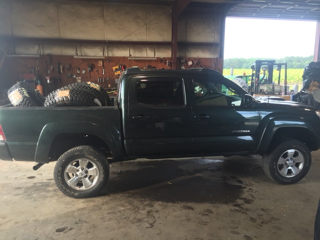

    887's lr ucas and dakars. 285-70-17 hankook dynapro on 17x8 pro comps
