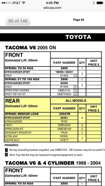

    Can someone give me a definite answer to this please:
    OME 886x - how much lift do they ACTUALLY give when paired on 5100s @ 0 or nitrochargers. I've heard 1.75 and i've heard a full 3"
    Will be going plate bumper soon and want to decide which route I need to go for additional lift after these.
    Thanks guys

    Neither.
    886 is a 2" approx. lift coil without spacers, on a plate bumper equipped Tacoma.

    2 1/2"

    50mm.. is 1.9".

    50mm is 2"
    I know the OME App guide says 50mm but I think they are considering that an ARB bumper with winch is applied .

    Well 1.968" of approx. lift with 110-220lbs of additional weight.
    On a stock truck, 2.5". On a non-stock truck, somewhere between the two.

    No , OME app guide says 2" with up to 220lbs
    So if your plate bumper is 100lbs or 150lbs , you will see more lift

    Not really , a 100lb plate bumper is not a stock truck , stock truck would likely see 3"
