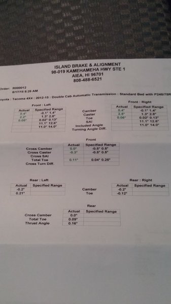

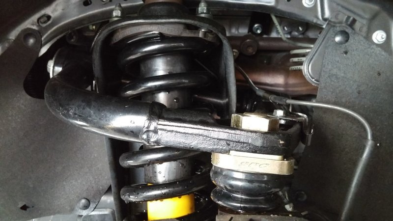

    Removed front mudflaps, had the alignment shop go with position "D" on the LR UCA's, and problem solved. No more rubbing!!!! Thank again Oz and Yota Lover for the advice/input. Photo of new position and new alignment printout below:

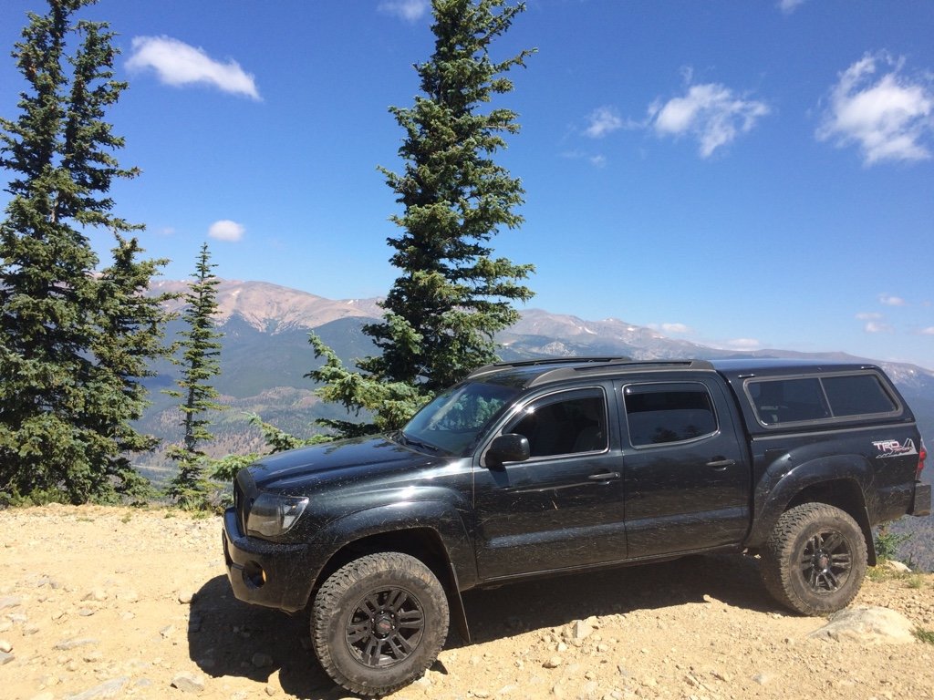

    OME works!!
