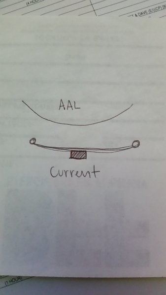

    One thing I'm concerned about that maybe you guys could chime in on is, I have a one inch block in the rear with the stock leaf pack (2.7l) and have done a couple of heavy loads and I'm a little worried that when I install the AAL it won't sit flush with the others. Like maybe I overloaded them and they're tweaked and out of shape...

    I'd think as long as they're not frowning you'll be okay.

    This is pretty much how it looks. I just hope they spring back to original shape...

    Supposedly the OEM leafs are "designed to be flat."
    I still think you'll be okay unless they're reverse arched already.
