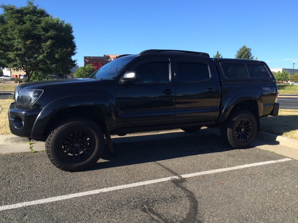

    I have 884's n dakars have topper as well but nothing in back for daily driving and the rake aint so bad. ee60b618755a1f8b4a7081cc7869623e_859c86174b25ee42a86501fc8befc75df795dd67.jpg
    Not the best pic i've taken but i think u get the picture, lol
    Dr. Jekyll likes this.
