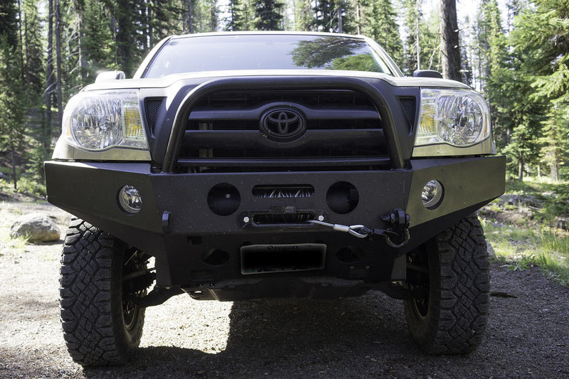

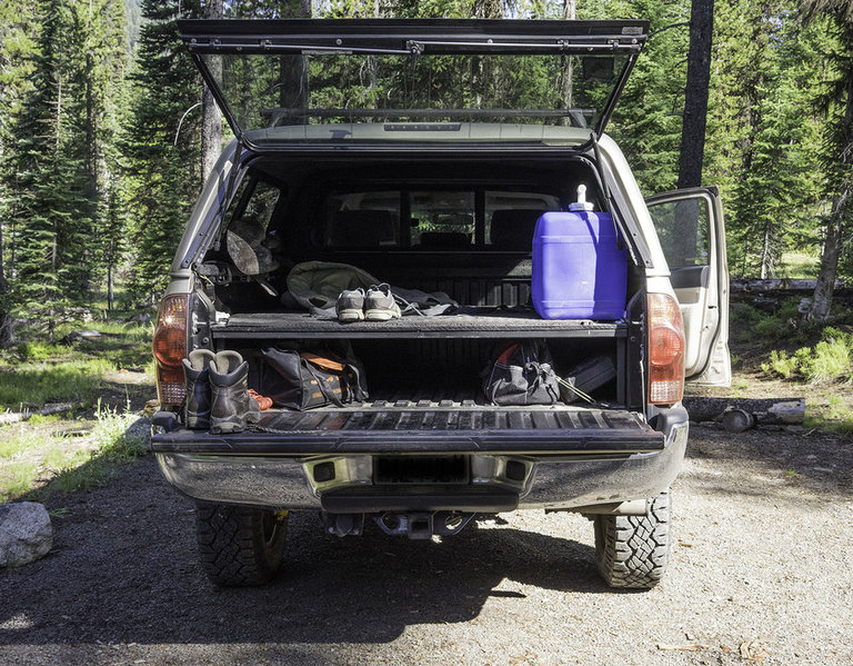

  20. Aug 25, 2015 at 9:41 PM
    #7620
    raggedphoto
    raggedphoto Well-Known Member
    Mar 7, 2015
    #150350
    254
    Oregon
    DCSB 07 Desert Sand Mica
    For long haul vs short crawl
    To chime in I have a shell with built in custom made deck, tools and 80 pound dog with camping gear. The Dakars have been the best part of the suspension upgrade, I bottom out far less and it handles so much better over stock. I sit with slight rake with my 886 up front with winch and steel bumper. Sure its a bit rough over mild bumps and potholes but the truck handles like a champ. I have since changed out the tires but here is how she sits now.
