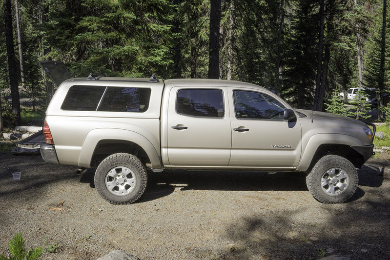

    raggedphoto
    raggedphoto Well-Known Member
    Mar 7, 2015
    #150350
    254
    Oregon
    DCSB 07 Desert Sand Mica
    For long haul vs short crawl
    Yeahhhh I hate it, those are 245 75 r16 I just bought some KO2 265 75 r16 but still need to do something about the stance. probably going to buy some spacers until new wheels are in the budget.

    Dr. Jekyll
    Dr. Jekyll Well-Known Member
    Aug 31, 2008
    #8899

  10. Aug 25, 2015 at 10:11 PM
    #7630
    T4RFTMFW
    T4RFTMFW Well-Known Member
    Jul 23, 2014
    #134525
    69,755
    245s!
    Got a side view?

    raggedphoto
    Mar 7, 2015
    #150350
    254
    Oregon
    Best I have from the same trip, I have since welded on sliders and changed out the tires. Honestly I went back and forth on what size to move up to, if there was better options in the 255 85 r16 world I would have gone that way. 285 seemed overkill and more for the "look" plus as silly as it seems given that I welded to the frame and removed the front bumper I didn't want to deal with rubbing issues._DSC1717.jpg

    T4RFTMFW
    Jul 23, 2014
    #134525
    69,755
    Not nearly what I expected.
    I don't want 285s either. Maybe 255 or 275s, if I ever jump from 265.
