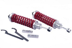

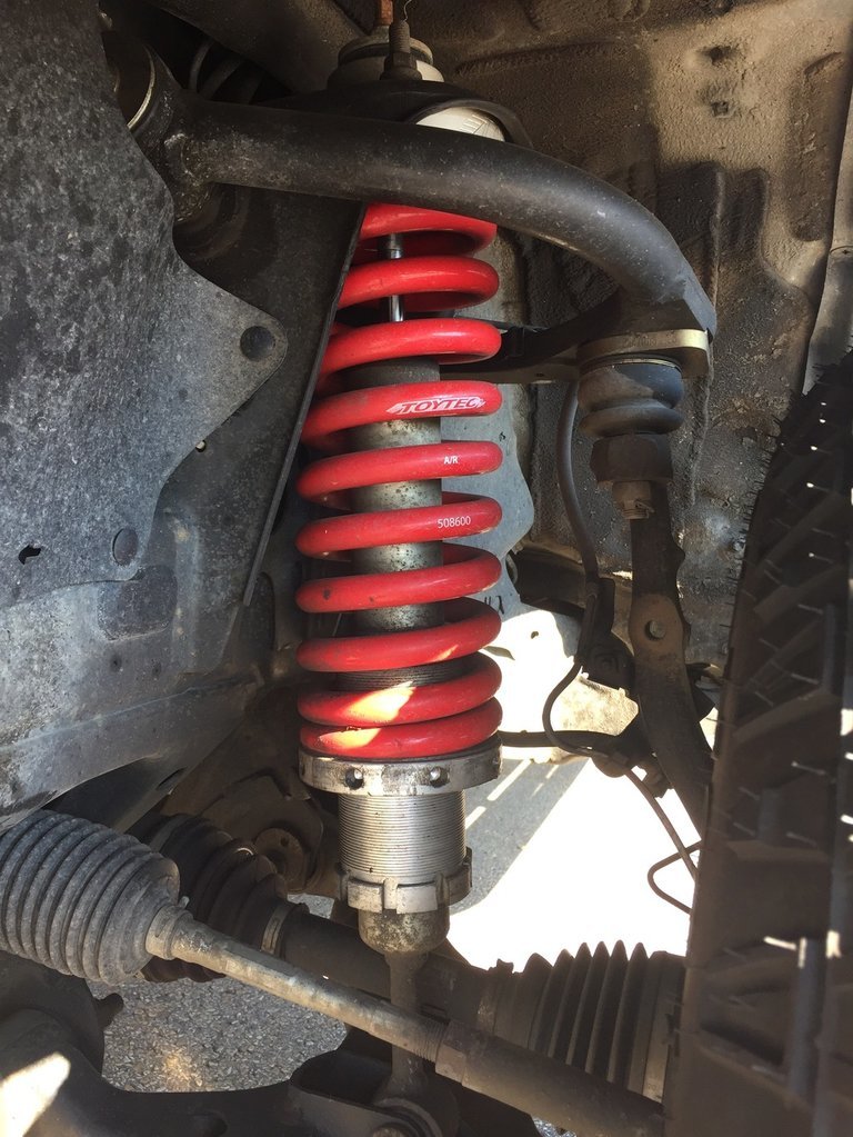

    Currently have Toytec/Bilstein 5100 adjustable coilovers installed. Since adding bumper I have a lot of pre load on them to maintain my lift height. Very harsh ride. I'm trying to keep the lift and improve the ride for little cost as possible. My question is can I switch out the coils only with OME 887's? Will the 887 fit on that Toytec setup?

    Might not. The OME coils are formed like the stock coils. The bottom diamter is actually smaller than the upper. See here, the upper mounting diameter is smaller than the lower in the pic of the spring:
    http://www.oldmanemu.com.au/products/coil-springs/

    Hmmm good point. Guess I could take my stock set up, put 887's and 5100's and sell my coilovers as another option.
