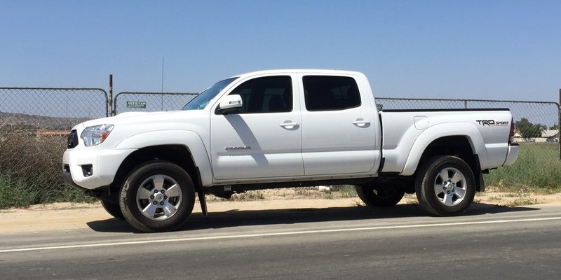

    Fresh OME suspension with 887's, Nitrochargers, Dakars, and Light Racing UCAs. Ride is way better than stock IMO. Still the stock 265 tires, but not for long :D

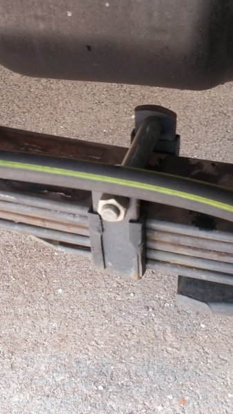

    I've had my Dakars on the truck for about a month or so now, and just noticed this:
    This is from the driver side leaf pack. Some of the rubber is missing/frayed off one of the retention brackets. All the other ones look fine, it's just this one. Is this something I should be worried about or need to address ASAP?

    @Miyagi it's pretty common for those plastic clips to break off, I haven't heard of any issues caused by them breaking. If you want to replace them for aesthetic reasons, the part number for the taller ones is 2516474 and the shorter one is 2512074.
