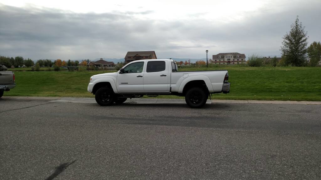

    Doing 887's is the way to get 3" up front. I did full Dakar rears and sat fairly level.
    After adding skid plates I now have rake again (ie front is lower than rear).
