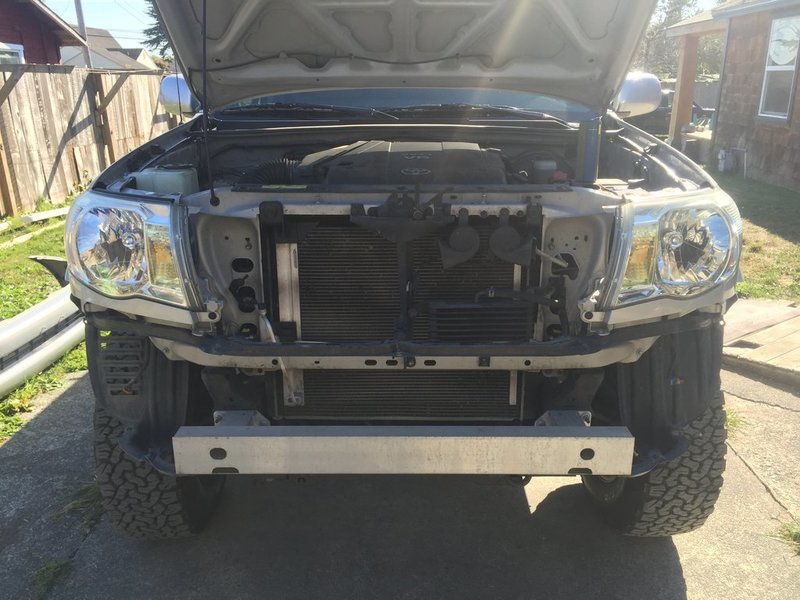

    Just put 886 coils up front and am putting an arb bumper up front w a winch (synthetic line). is this gonna be enough to pull the front end down a bit? Looking a little Bro-ish right now with the nose in the air.

    ARB and winch? Oh yeah. That'll help to bring it down again.

    Left my 10 mil spacers on the coils in order to get the full 3 inches. Should I have left em off or will this settle like the 885s did before the bumper. I want a level lift in the end

    Did you update the rear with anything?

    FWIW I have dakars paired with 886s and no spacers. With ~135lbs hanging off the front and full skids I have rake. With your setup you'll be about 200lbs right? I think you'll be sitting pretty. If not, pull the spacers out.

    Ya at least 200 lbs. guess I just put the bumper and winch on and see what it does.

    Put it on and then jump up and down on it :D

    image.jpg Here we go....
