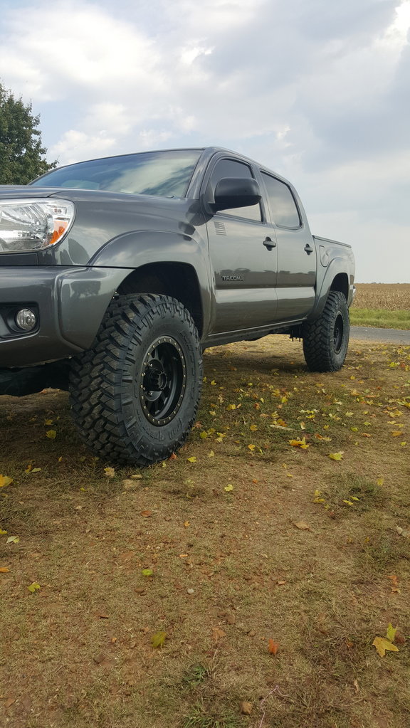

    Finally got my OME lift on, 887s, and Wheelers Progressive AAL.

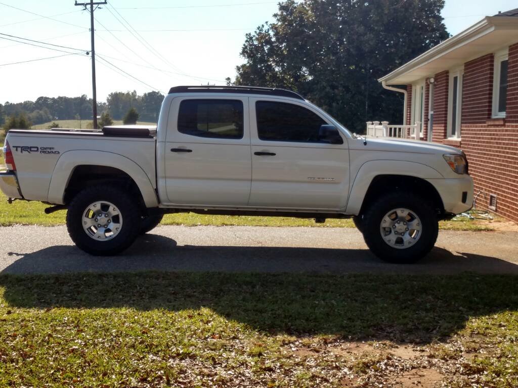

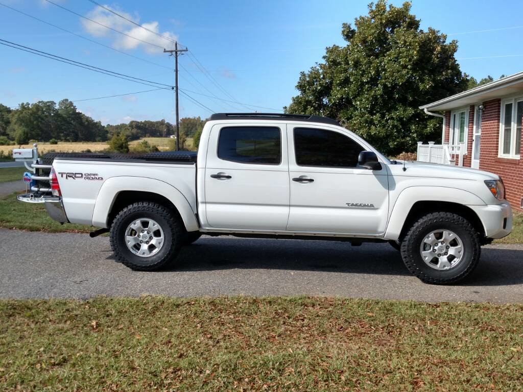

    Before:
    After: 885 and dakars

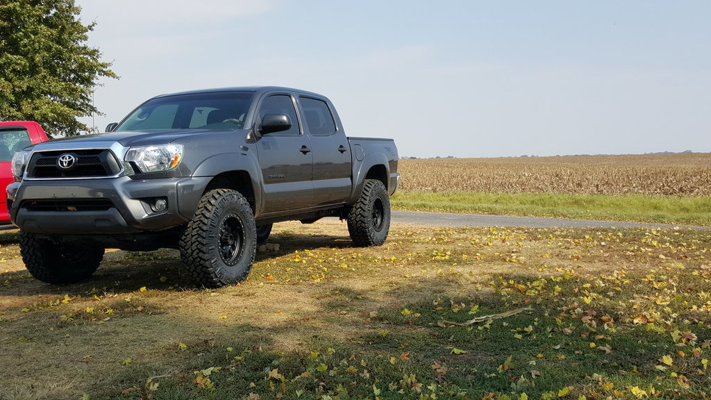

  5. Oct 14, 2015 at 3:23 AM
    #8045
    Jeffvt0508
    Jeffvt0508 Well-Known Member
    Sep 5, 2011
    #62959
    14,380
    Jeff
    Anderson, SC
    2015 DCSB 4x4 trd offroad
    Ome 887s, dakars, lr uca,sliders, konig countersteer,

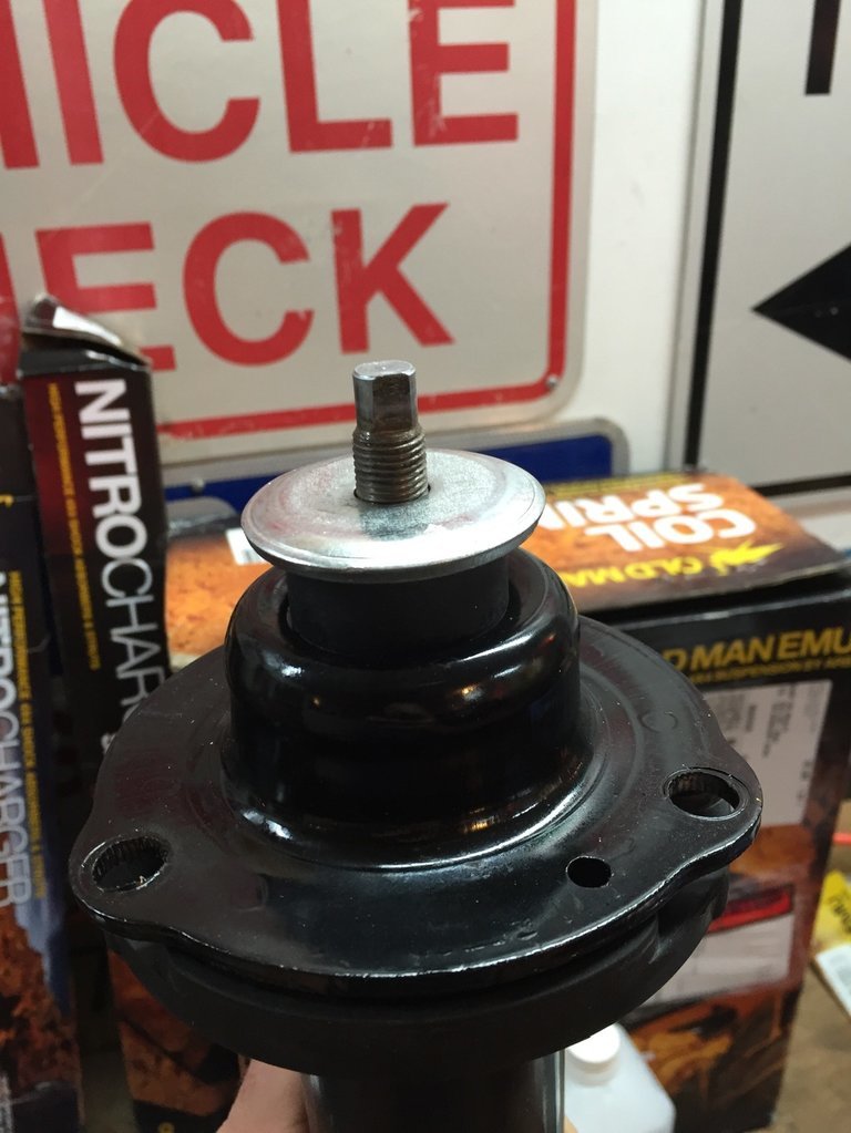

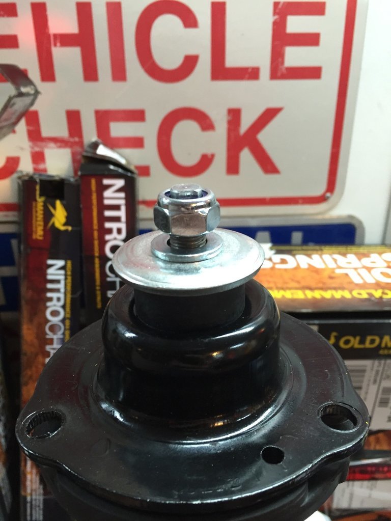

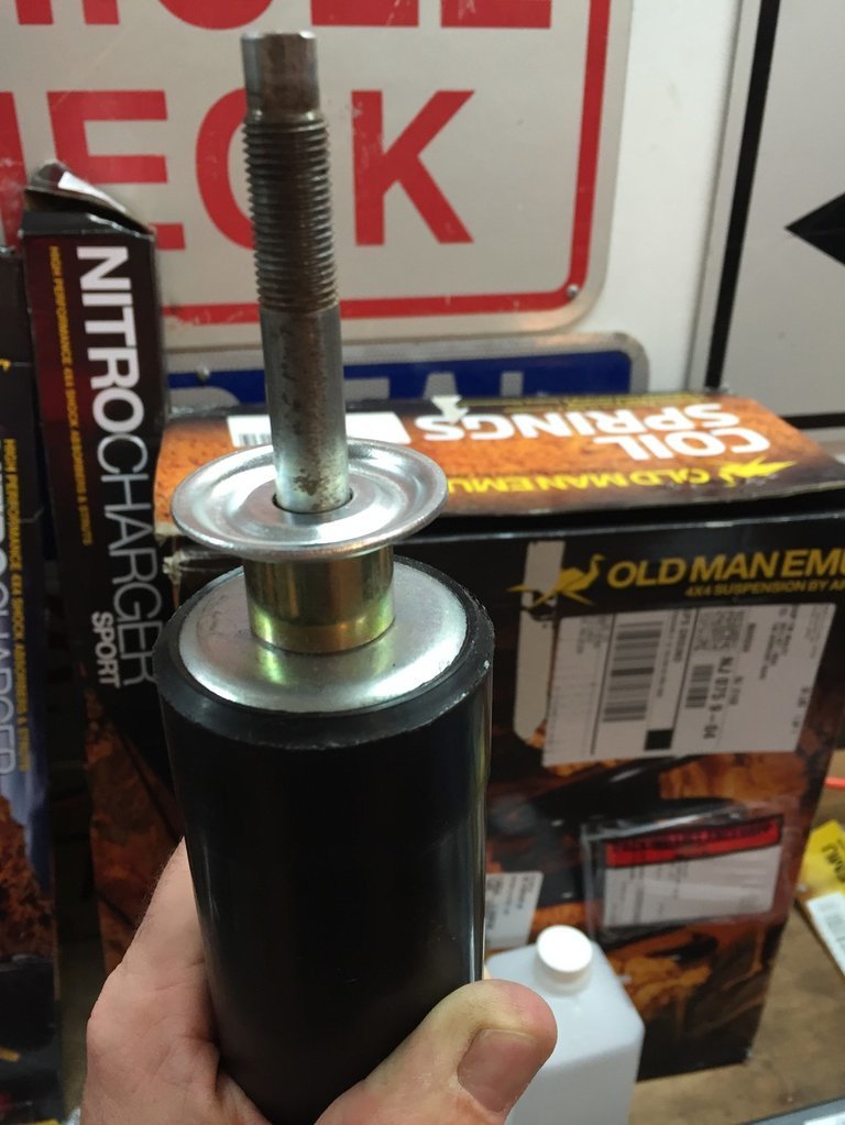

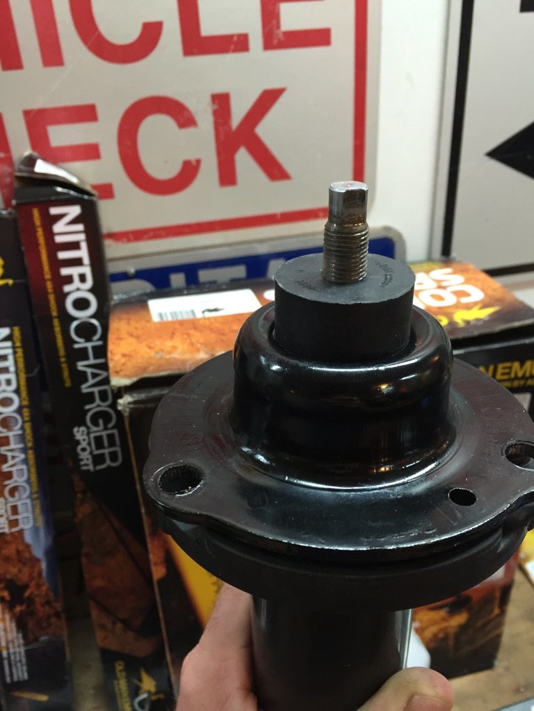

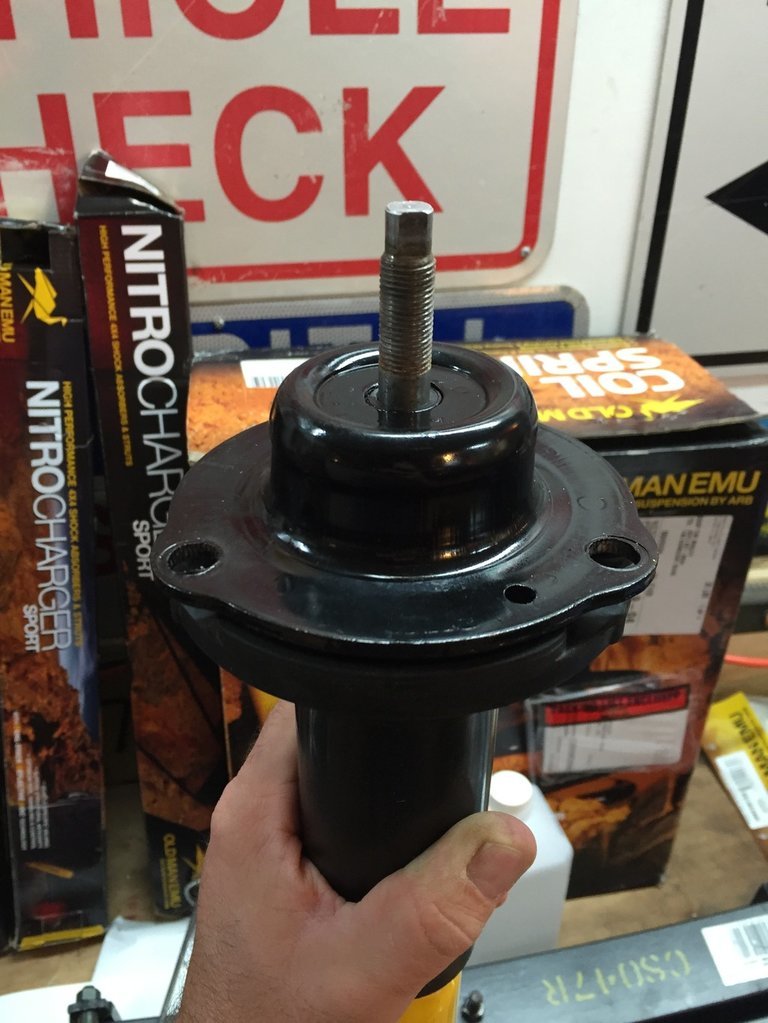

    Hey guys, I posted this in another thread. No response...
    "Alright, I'm starting my lift tomorrow night after work. I've done this before but it's been a couple of years now...
    Every video or write up I can find just says something like "assemble washers and bushings in correct order", without a description of said order.
    Since I'm going to leave the 5100's with stock coils assembled when I remove them, I won't have anything to go by.
    Anyway, please tell me if I have this correct:
    36B1BFF6-34E1-4AC6-95B1-A780C883B3DA_zps_eb278bc92f6d1453ba7ffdb176b4c4fd19971473.jpg
    3AF24507-A0C3-4259-9BE1-AB4400543BFE_zps_21b23a8088519e3029bd110bb799cf71618c99df.jpg
    5F55DEA5-20F9-4982-A480-8AE870DE3C4D_zps_ebb9eee29ed9d22584ab72e9f907f692d2f07518.jpg
    AC3FEED3-675C-47F3-A0C5-EF5BC10AB154_zps_573bd329dd71be3e81315192ed188ff0e526744c.jpg
    F1D3E551-D86D-4F83-9AB2-6663062E164F_zps_a2b4fdb2eef47403666a44b1fe46b845bb68ec66.jpg
    Pretty sure I got it. Please put my mind at ease! :D"

    14,380
    Jeff
    Anderson, SC
    Should be a bushing under the top plate.. Correct?
  19. Oct 16, 2015 at 3:32 PM
    #8059
    Jeffvt0508
    Sep 5, 2011
    #62959
    14,380
    Jeff
    Anderson, SC
    It may be pre assembled in the top plate but make sure
