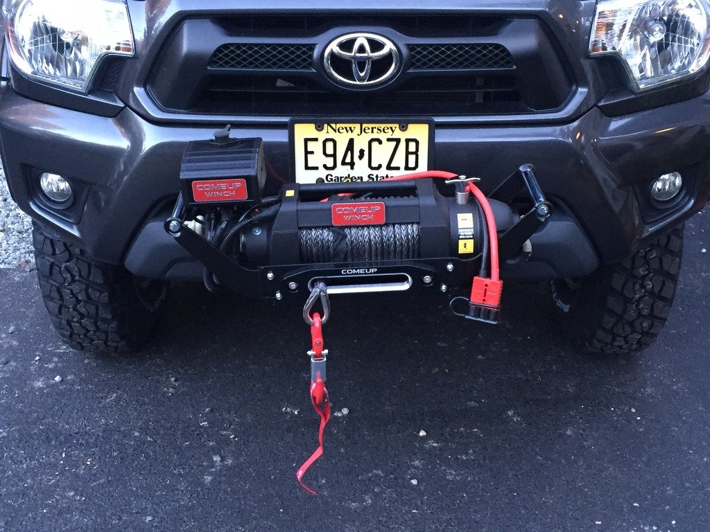

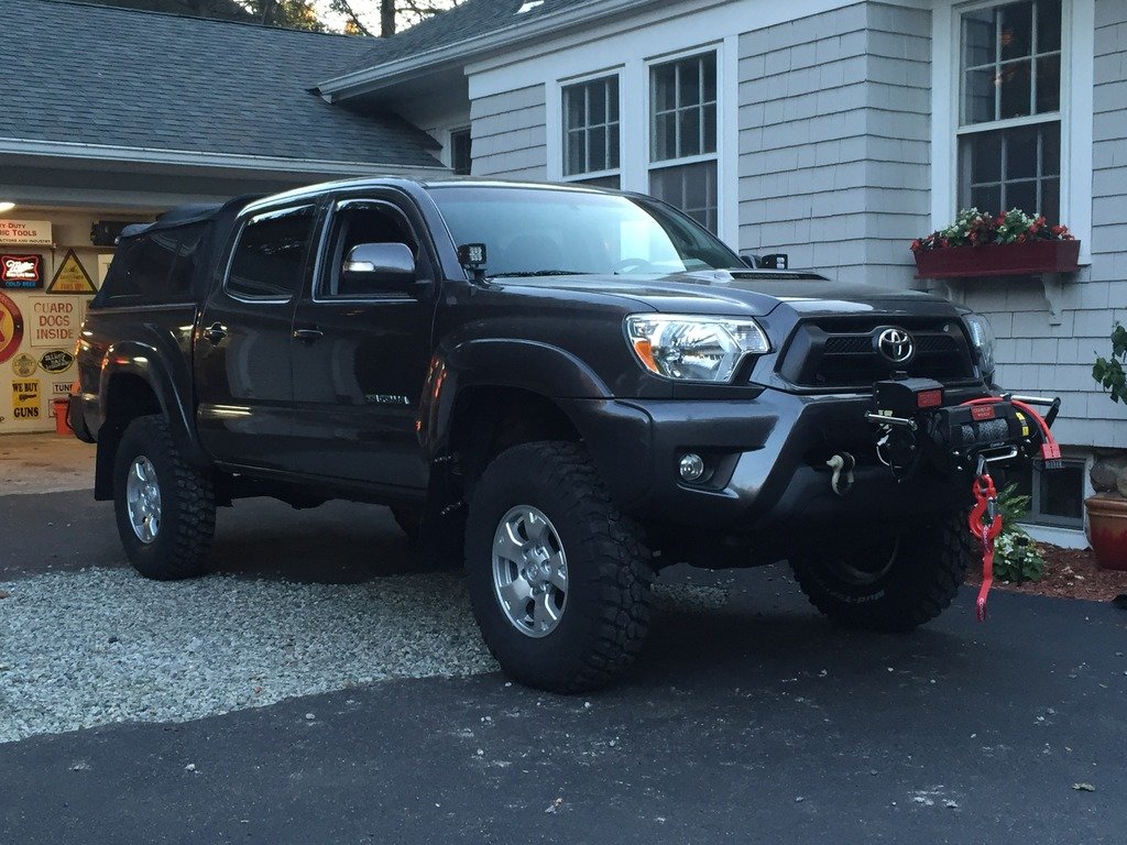

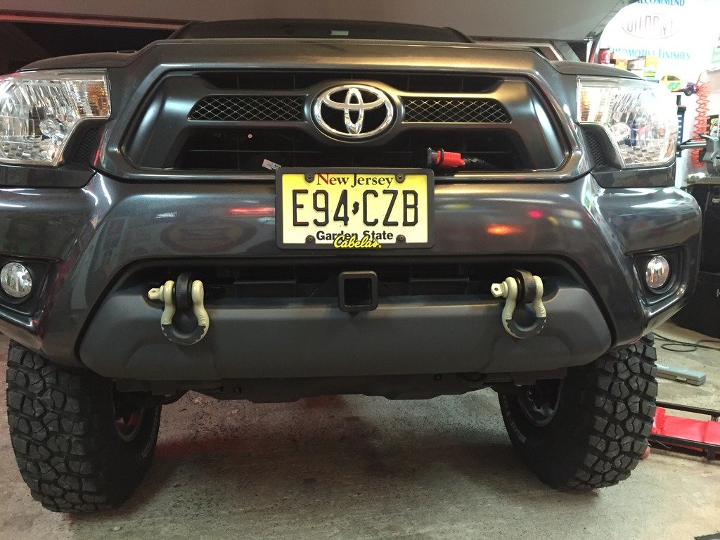

    Finished:
    426465FF-2DC8-42BE-8F0E-E4A824BCBE31_zps_5f0700b89660e46460b6450af75c8464ebfdbb58.jpg
    ACBF32C3-6C29-4D1B-AE6A-92CC12133A75_zps_24f87f80fd75ed7f051ab9c7bfd3470c2cc32c10.jpg
    EDIT:
    Below, I state that my Mobtown recovery bar receiver hitch came welded on crooked. Well, Joe at Mobtown saw this and contacted me before I could contact him. He stated that their jig was bent unbeknownst to him. He is sending me a replacement recovery bar right away. Awesome customer service. Thank you Joe!
    I had time to install the Mobtown recovery bar as well. Unforuatley, the 2" receiver part is welded on a little crooked. AND it's crooked in the wrong direction. Meaning, the winch is heavier on one side. So, even if the receiver were straight, it would Lean a little to that side. The receiver being crooked just exagerates the lean.
    Im actually quite bummed about this. Oh well, it'll still get the job done. I think a thumb strap down to the recovery shackle on the drivers side will make it sit almost level when the winch is in. Obviously, when actually using the winch, it won't matter.
    7101F0B4-62EC-4F80-9687-1529ACC80A43_zps_35e93bd07bb229390425017cd428fd28d4bac872.jpg
    5F9B79AC-2224-4E21-A96E-F705D0436432_zps_4a90581f41ddfbdfe2d7865dce82fbb970aeba33.jpg
    82590D55-5834-4A97-9FD7-37EF66E0A3E3_zps_a9549efcd52ab404c55bd42b80112002ff854390.jpg
    Anyway, back OME stuff...
    With 886's and 1/4" spacers, full Dakar pack, and 10 PSI in the rear bags, initially, the front was 1/2" higher than the rear. Measuring at the pinch weld below the doors front and rear.
    After taking it up the road a little way, it now sits dead even. I know it'll settle a little, but with the airbags, the rear should stay the same. I'm thinking I'll end up with the rear a little higher than the front. But, level is fine too. As long as it's not nose high, I'm happy.
