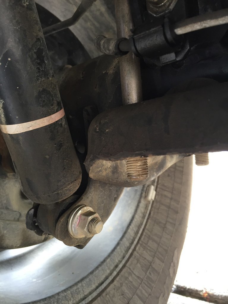

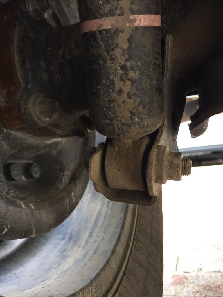

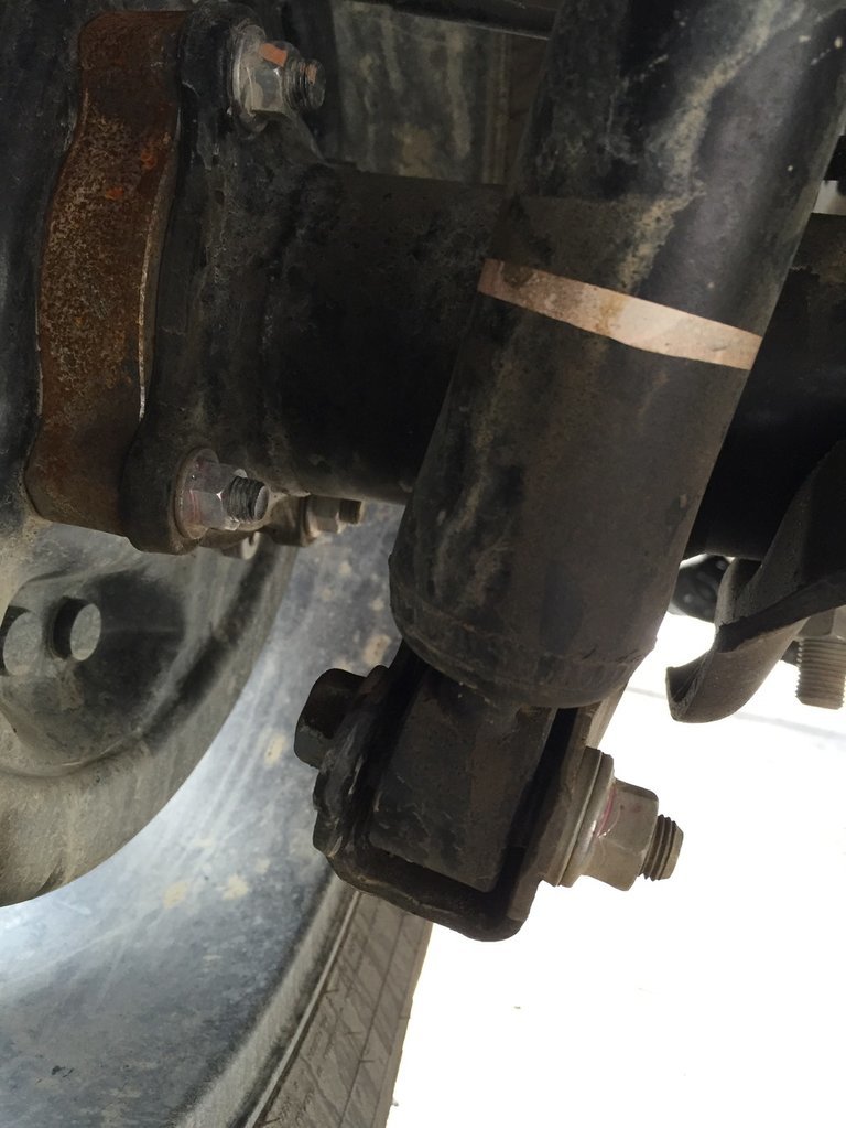

    Can someone which a pre 15 take pics of their rear shock brackets on the axle housing? I'm trying to find out if mine will work or not. I read some 15's need trimming and some don't.
    This is my drivers side
    4A7C7F66-DFF0-47A7-9598-BD18A171A595_zps_fdcd5eba44df4d38b53ae20c5fe855641a0d2df9.jpg
    79610832-48D9-4DFE-9003-2BEFC5E9C4F6_zps_06761b8130bfeb691022a236ca5ffaeef778ba6b.jpg
    3CE94297-6855-4686-B20D-D6EE0B19C91A_zps_3cb92d2bb120a7c66ac9c1106ddeffd13de5196e.jpg
    Passenger side
    2AE4BD34-5A56-4175-9BCB-DCD338785FBB_zps_cf214db493031acfc27528297fba619cc03a05de.jpg
    BBAF60D0-2019-42C0-9B81-D61156710783_zps_f612d719149a20dd6e0f5e05a821eb4740002f7a.jpg

    You actually won't know until its on your truck.. Mine hit on the outer most lip closest to the wheel it would have been fine but I wanted more clearance between the mount and shock

    mine will need trimming. This is a pic closer to the wheel, see how much more it sticks out.

    Mine had to be ground down. Assume you have to and be happy if you don't.
