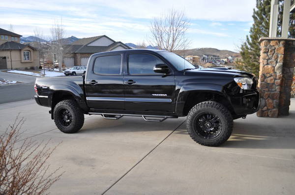

    Pulled the trigger on an OME lift for my 2013 DCSB TRD Sport.
    Here's what I had installed (yeah I know, any self respecting Tacoma owner should do their own lift)...
    OME2885 Front Coil Springs
    90000 Front Struts
    CS047R Rear Leaf Springs
    N182 Rear Shocks
    FK29 Driveshaft Spacer
    U53A U Bolt Sets
    4 x Toyota leaf spring bushings
    Did not change the UCAs.
    Rides great and looks great! Glad I went with the OME set up!! Thanks for all the info - for those with the patience to read lots of posts, TW is a wealth of information!
