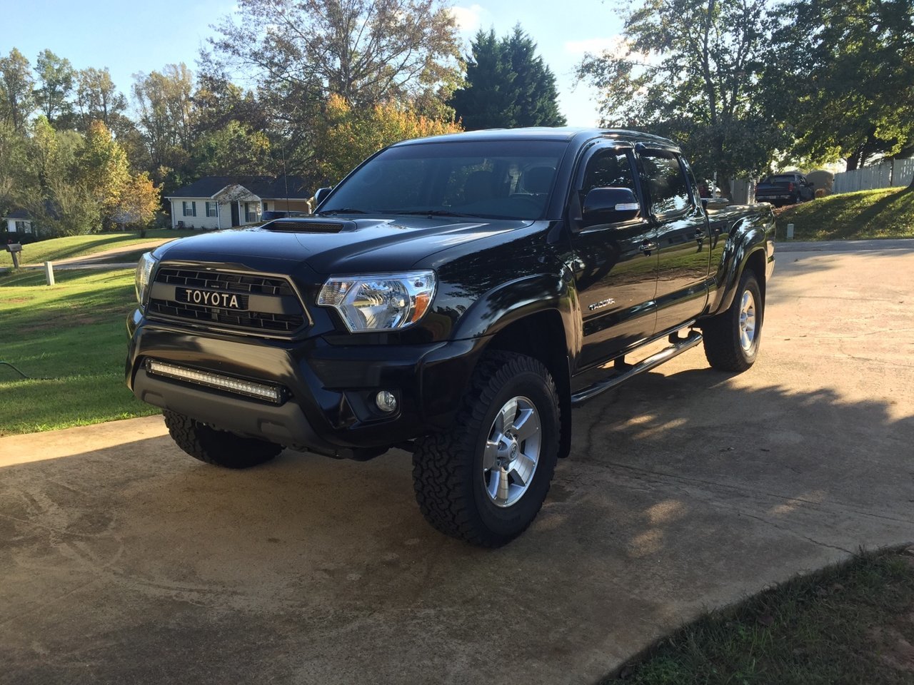

    I didn't mean the Dakar AAL. I was referring to the Dakar Leaf pack. This is the kit I'm looking at. I know it is advertised as a 2" lift, but I would like to get as close to 3" as possible to clear my 285/70/17's in any condition while still being able to carry weight. d4dd1a5f278e14f123c66ce120b9c144_9c486cc566564f6a12e08720c99a1ea42db5eeeb.jpg

    Thanks for the advice. I may just end up doing what you suggested. I was seriously considering the 887x's until I get the bumper, winch, skids, etc. I was doing more reading and everyone seems to hate the ride on the 886x's until you have about 200 lbs. on the front. Like I said I can handle a rough ride as I am used to driving sports cars and race cars with stiff suspension. But how stiff is it? Would it be wise to get the 887x's until I get the front end sorted? The 887x's with the 90000 Nitro's should clear 285's right?
    This is how I'm sitting right now with the 285's on a 3" spacer up front and 2" blocks in the rear. I'm only rubbing on the stock UCA at full lock. Off road with quite a bit of flex there are no issues. I just ordered SCS F5 wheels which should give me the correct backspacing to clear the UCA. So in theory I should clear with the OME kit as it provides about the same lift. I should only have to make adjustments upon adding weight. Does all of this sound right?
    Thanks for all of your patience. I get a feeling I'm overthinking this a little bit.
