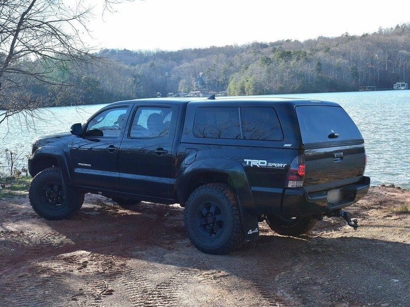

    Blacked Out-887-Dakars-LR UCA-FJ Trail Team wheels-285 BFG KO2
    That is the setup I am running, minus the 3* shims in the back.
    285s on 887s and Dakars...

    Nice. Any fitment issues with the 285's? Nice looking truck by the way!

    Appreciate it... Nothing serious on the fitment. Up front, I had to remove the front wheel well splash guards. And then I was rubbing on the inner corners of the mud flaps. I took a heat gun and molded those corners flatter. I haven't rubbed any since doing that.
    I did have a buddy that was helping me... Did make it a lot easier to guide the center rod through.
    B3NDR[QUOTED] likes this.
