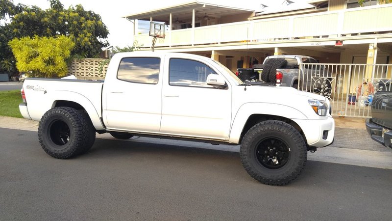

    Picked up a set of 285/75/16 Duratracs. Will I be ok with 885s? 0204161719.jpg

    Yes, but you'll need to do the cab mount chop and some minor trimming. I have 885's and that same tire size.

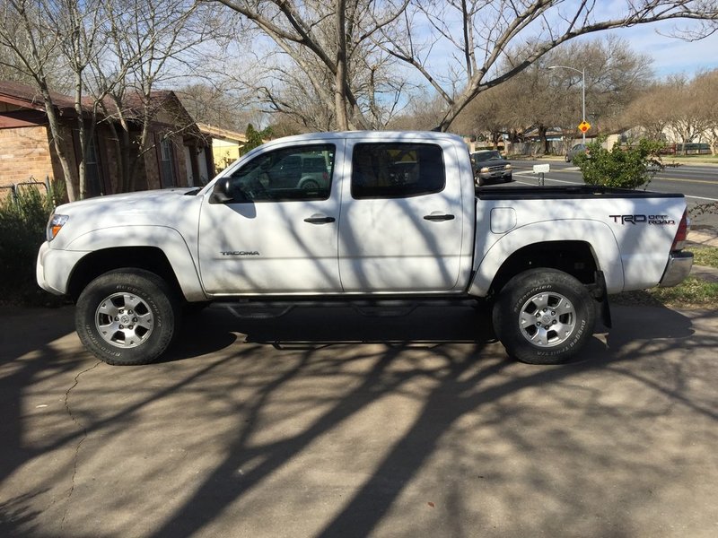

    Here's mine with full Dakars on the rear, 887s on the front, and stock 265/70r16 Rugged Fails.

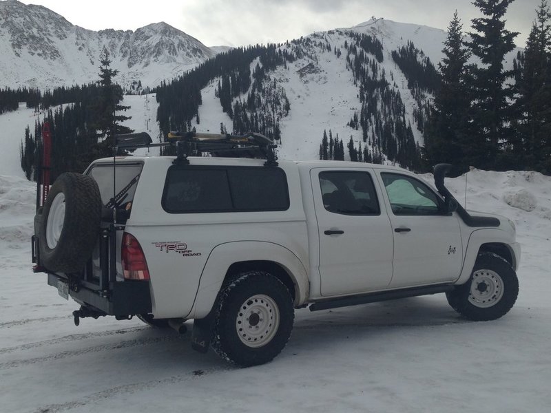

    Getting some thoughts on my potential set up. Wanting around 2ish inches front and 2.5 inches rear lift.
    Specs on truck:
    2006 dcsb 4wd trd or
    Topper
    Offroad rear bumper with swing outs
    Sliders
    Front steel skid
    - it's sitting pretty low and with all my swing out bumper and sliders on its easy to bottom out. Original 2 + overload leaf pack and stock front suspension.
    Lift I'm looking at doing:
    Used 885x
    5100s front and rear
    Dakar rear
    I'm hoping to get away with stock uca until I make a front bumper for it

    Just the stock spare 16" steelies
