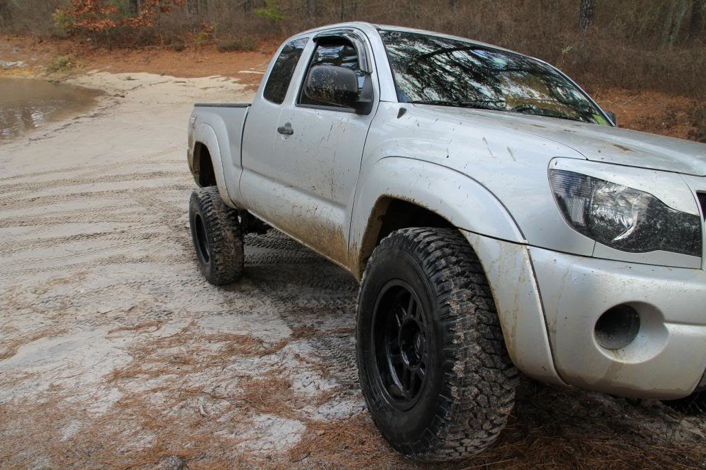

    before measurements front and rear:
    LF - 20.0 RF - 20.50
    LR - 21.50 RR - 21.50

    Standard or extended length?
    I had to lift my rear axle several inches to put the top bolt on.
    So I know mine will droop a lot more with the 3" shock extenders.

    agreed
    extended length

    I thought so when I saw the pic.
