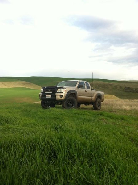

    2006 Tacoma V6 4.0L 4WD Dual K&N CAI Cherry Bomb glass pack +3 inch OME coils 3/4 inch toytec spacers Deaver 1.5 inch AAL iDelta toolbox Cree LED 7.5 inch lightbars on a bullbar 33in SVT Radial Wild Country
    Here's a pic of my truck with 884s and 3/4 inch top plate spacer. I've got a 1.5 inch
    AAL by deaver in the back
