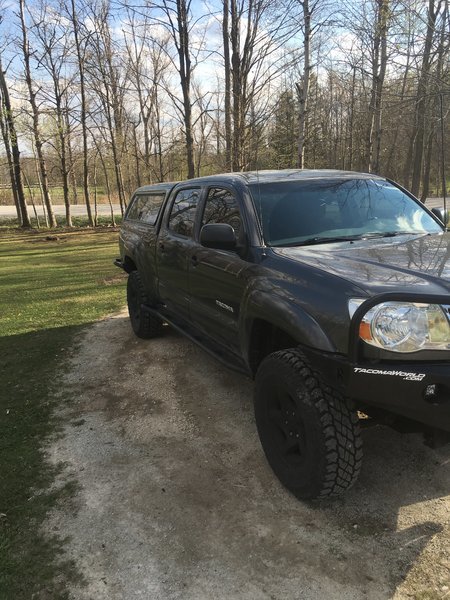

    Same thing with mine. I'm actually sagging now in the rear but I was about levelish. High clearance bumper maybe though.
    Ass end high
    Leveledish
    sagging
    And just for reference when I had no armour

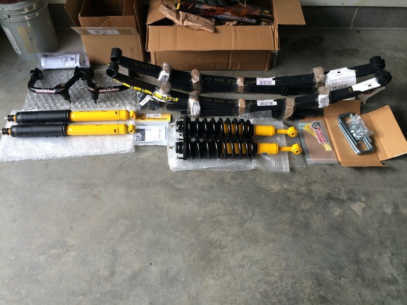

    This arrived last night... Just need to order tires and wheels now. I'm still not sure what size though. :frusty:

  10. May 11, 2016 at 11:52 AM
    #9530
    la0d0g
    Jan 25, 2011
    #49903
    19,907
    running for the hills
    For crawling not hauling
    35s of course.
