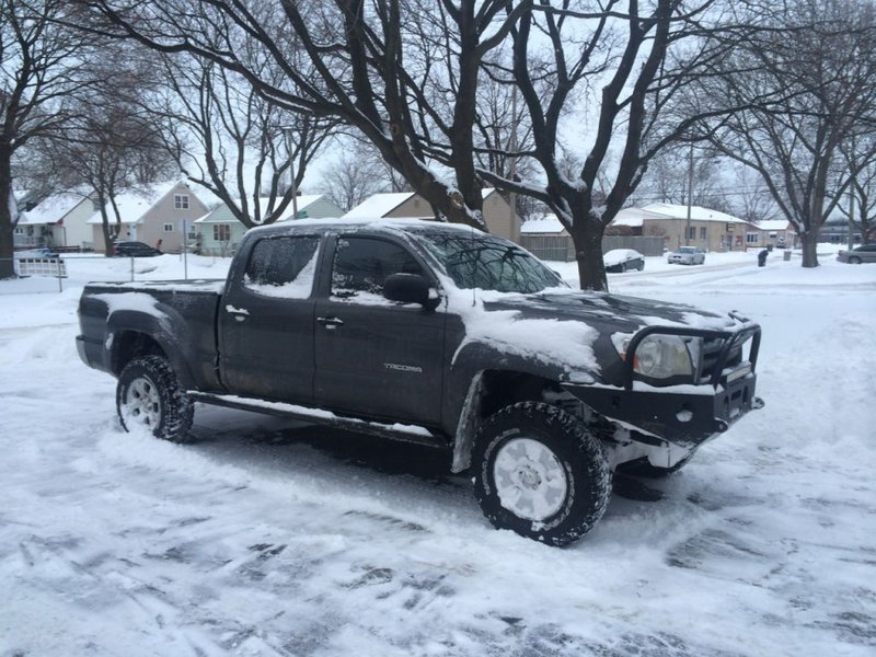

    Dakars in rear with 886 up front. No bumper at all just the crush bar. Have IFS, tranny, and transfer case skid and sliders. This is how it sat after hauling wood. First week of getting it on.
    Couple weeks later steel bumper on and some snow.
    Couple months later with nothing on the rear though.
    Gives you an idea of how it is and how it eventually settles

    So it really didn't drop any in the front. Looks pretty close to level, mine is 2 inch difference from front to back

    domt believe it dropped. Even with the bumper. With the winch now, it has slightly but not really noticeable. You should be about level. I was about level with nothing other than skids and sliders.

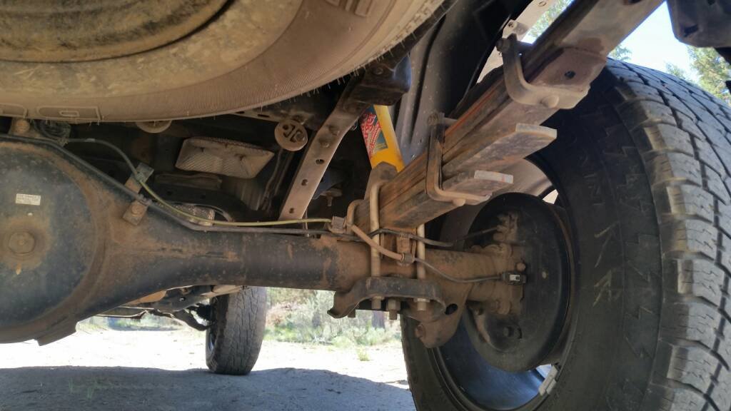

    Which leaf should i remove to drop the rear a little and make for a slightly softer ride?

    3rd down
    Might want to wait till you add the rear bumper though
