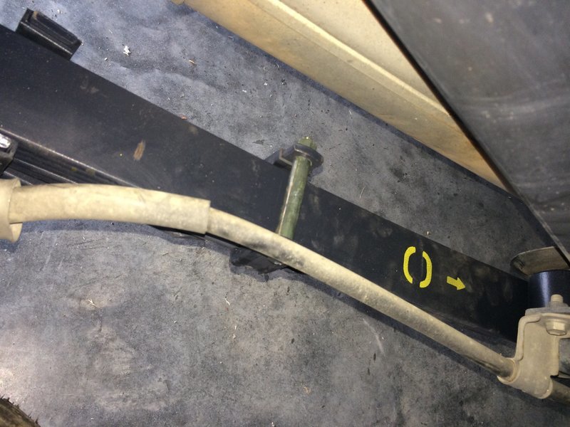

    dakars in the back. would that be stamped on top or bottom?
  7. May 19, 2016 at 1:17 PM
    #9607
    la0d0g
    Jan 25, 2011
    #49903
    19,912
    running for the hills
    For crawling not hauling
    Top, mine were in yellow

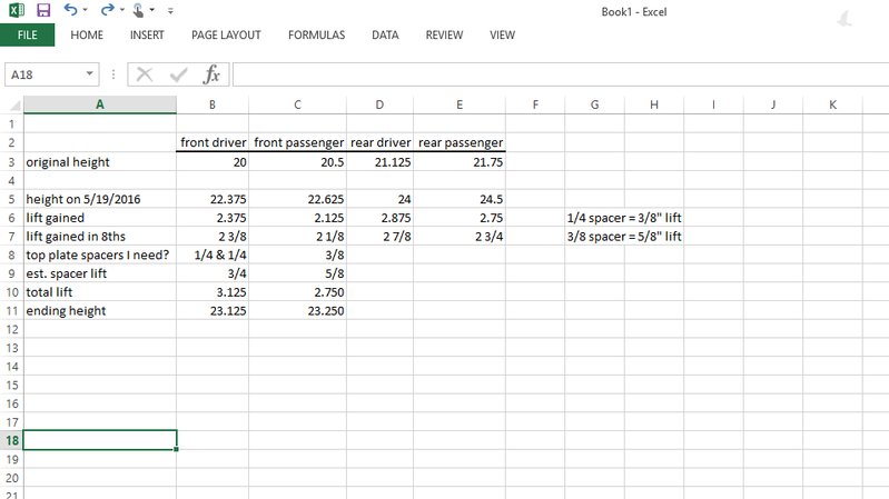

    But still...my original front measurements were 20" driver and 20.5" passenger. Which one do I calculate my lift from? Just average them to 20.25?

    Does the zero (0) mean that the leaf is not above or below the tolerances when tested? ( as opposed to + or -) I've got dakars on order and would be good to know before they arrive

    Well, that's the problem. Say I want 2.75" of lift. Calculated from the passenger side, which is 0.5" taller. If I set both sides to be equal (I'd like for the sides to be level) that would be a 3 1/4" lift on the driver side to match the passenger side.

    Dont some come marked + or -?

    I gotcha. You care for it to be level. Do the 10mm spacer on the DS and the bigger one on the PS.
    Yes. If you get them like that the ++ goes on the drivers side. If you get a 0 and --, the -- goes on the passenger side. Etc.

    Cool thx, I wasn't aware there was a (0) as well

    Lift amount has nothing to do with leveling. If the drivers side started lower it will end up lower post lift. Get a quarter inch spacer on the driver's side if it bothers you that much.

    The whole point of my question was to get some input on what spacers to add. I still need to add a bit more to each side, but still make it closer to level.
    So as you can see, on the front passenger side I started out at 20.5". That was 1/2" taller than the driver side.
    After the lift, I went to 22.625" on that side. That was a net gain of 2.125" on that side, which is 2 1/8".
    The driver side gained more, but started at a lower height. It's actually still shorter on that side.
    So... I was going for 2.75 to 3" of lift. I didn't get that on either side in the front. So it's just not the fact that it's not level. It's shorter than I wanted and still not level. I need to put top plate spacers on both sides. But which ones?
    After some thought...if I add a 3/8 driver and 1/4 passenger it might be more in the range of what I was going for.
