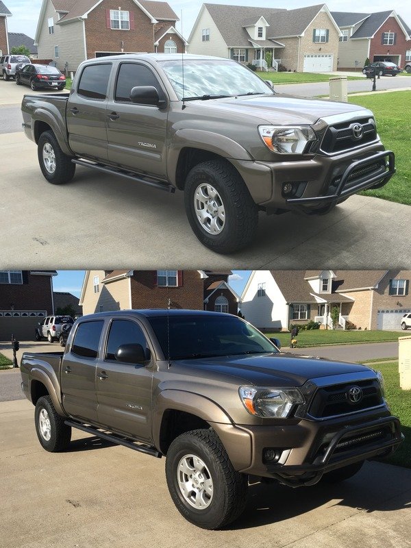

    Finally got my OME stock kit installed. I remember now why I loved OME so much when I had it in my old Land Rover Discovery - the ride feels tighter than stock but also less harsh over bumps and whatnot.

    Truck looks awesome man!!
    Any tips? I am installing my this weekend!

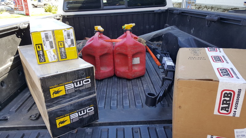

    20160609_160507.jpg My Dakars showed up today, we'll one of them they got split up in transit the other is coming tomorrow lol... is there anything I should do to prepare them before installing to mitigate the possible squeaks etc? Greasing, zipties, plastic shims?

    Good window... Thats what I estimated after asking around
    Any rust on your lower control arm bolts? The camber adjusting ones. They like to sieze to the inner bushing sleeve... Id recomend getting atleast new bolts for that... If not get antisieze and pull them apart and put some anti sieze on them... Might as well since you will need an alignment anyway after lol...
    IronPeak[QUOTED] likes this.
