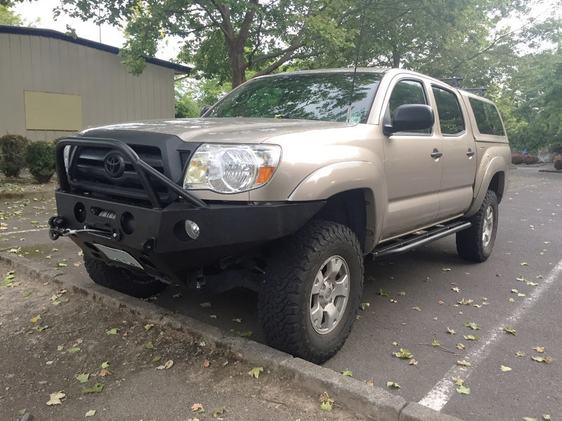

    How much weight up front over stock?
  12. Jun 24, 2016 at 10:48 AM
    #9852
    raggedphoto
    raggedphoto Well-Known Member
    Mar 7, 2015
    #150350
    254
    Oregon
    DCSB 07 Desert Sand Mica
    For long haul vs short crawl
    A little under 200 pounds. Steel plate bumper and winch with a steel cable, if I could do it over again I would've spent the extra $ on a synthetic rope to save some weight.
    crappy pic of how she sits as of a few weeks ago.
