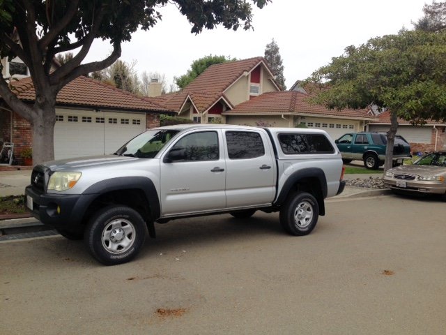

    here is a pic of my DCSB, 4x4, V6 with camper shell and full OME kit with 885 up front and dakar rear springs, They also recomended trim packer up front which I installed since they gave it to me.

    Looks great. How much lift did you get all around? New UCAs? Any issues? Happy with it?

    No New UCA, still using the stock ones, I had the usual issues = vibrations
    I did the ECGS upgrade due to vibrations up front , ended up using 3/4" spacers below CB, that seems to be best for now, just a slight vibe at 30mph and goes away below or above 30mph
    I tried the flipped 180 degrees CB, but that still had a vibe 0-20mph aside from that it was smooth
  12. Jun 27, 2016 at 5:06 PM
    #9872
    jtkkz
    jtkkz Well-Known Member
    Sep 22, 2011
    #63954
    150
    Bay Area, Ca.
    2005 Tacoma DC 4WD
    OME lift kit / Fifteen52 Analog wheels
    I am happy with the ride, we do a lot of mountain biking and with the dakar rear springs it no longer bottoms out when loaded with bikes and gear.
    I am not sure how much lift all around, but based on my friends same year stock truck, it looks like my rear was 2" higher and front about 2.7" inches higher
    Bannerman likes this.

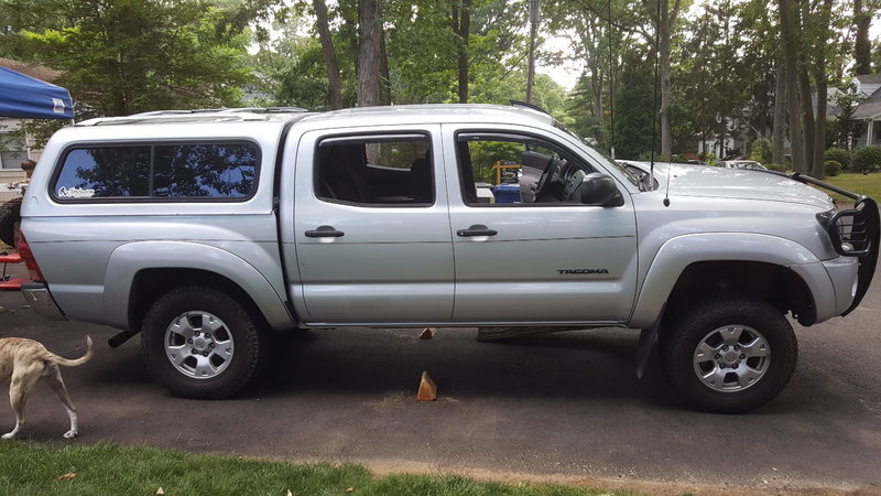

    Okay here you go everyone 885s , full Dakar with a topper. At about 24 1/4" in the rear and 22.5 in the front

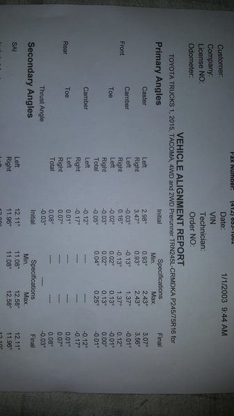

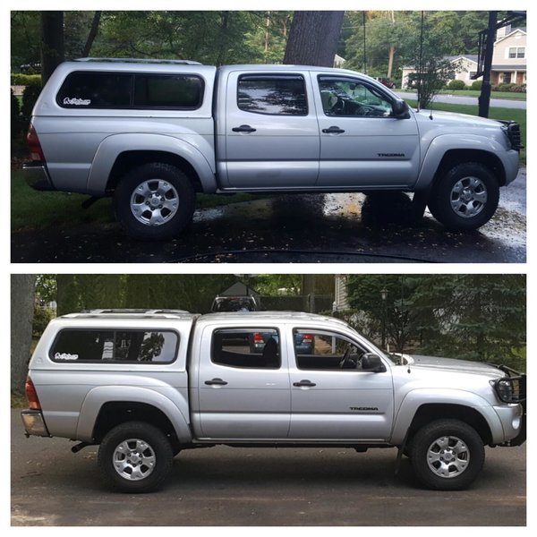

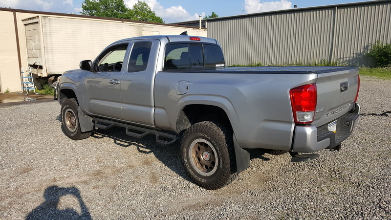

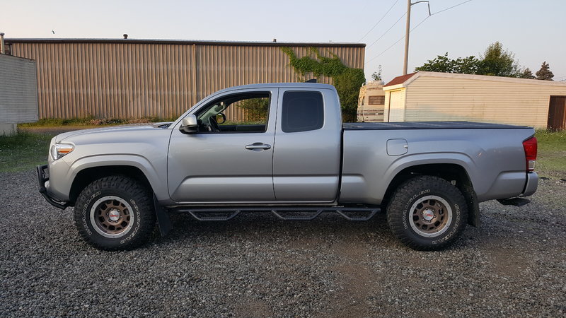

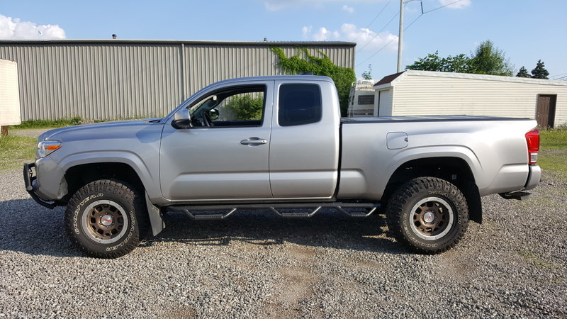

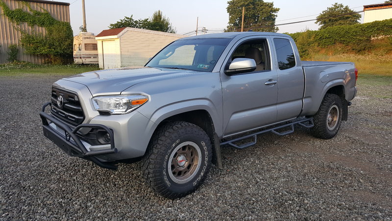

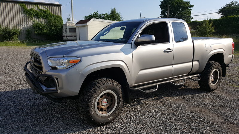

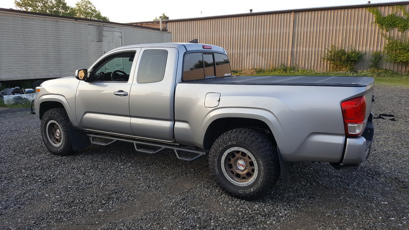

    Well guys I installed my setup last Saturday and I'm very pleased with the results and the ride! Way better than the stock ride! 887s and dakars with light racing upper control arms!
    This is on my 2016 SR 4x4 5 speed!
    Stock suspension:
    Front: 21"
    Rear: 22"
    OME Lift suspension:
    Drivers Front: 23.75"
    Passenger front: 24.00"
    Drivers rear: 24.75"
    Passenger rear: 25.00"
    Before:
    After:
    Before:
    After:
    Before:
    After:
    Alignment specs:
