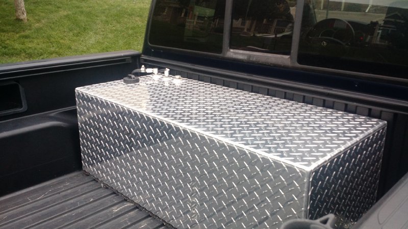

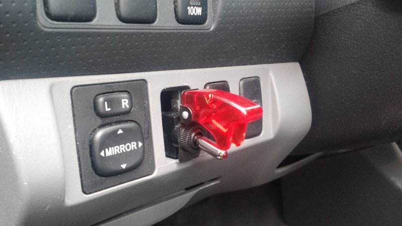

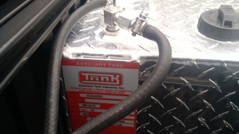

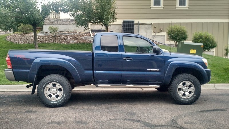

    Show off my AC? Twist my arm..
    The mod I'm currently most proud of: 42 extra gallons.
    That switch activates an auxiliary fuel pump I mounted under the bed, which draws fuel from the aux tank into the primary filler neck, so essentially you can refuel while driving if desired. Takes about 11 minutes to fill the primary tank (~18 gal). I get about 1080 miles on the highway.

    Nice rig. The tank is awesome.

    I'd be willing to make a write-up about it if enough people are interested. All in all cost me about $600 (custom tank itself was about $520), did the install myself over the course of a weekend.
    Anyway, thanks, I love this truck. Looking forward to several more upgrades in the near future... cap, mounting my US Offroad winch bumper and Engo 9000, then a CB & HAM radio setup to follow.

    Awesome fuel tank!
