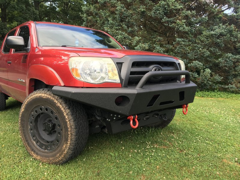

    I could use some advice on parts for the rear of my truck: DCSB
    Armor: Steel bumper, all pro skid ifs, tranny, and transfer case skids
    Currently stock suspension, but I'm buying 885 coils and N140S shocks and Kyb top hats for the front
    I don't know what to do for the rear. I have the rear TSB that's all.

    I have same set up with armor plus sliders and tank skid, full ome kit with Dakar in rear, nitrochargers, and 885. I will be exchanging them for 886s because the front end is going to be much lower than the rear with all the extra weight.
    So for rear I'd say Dakar or all pro aal or similar, plus shocks, front I'd say 887 or 886 because you have armor

    885s with no weight is great, I have v6 dcsb, even with front bumper is pretty good. Not adjustable tho

    Do you think 885s will sit really low with the weight vs 886?
    I'm not looking for a huge lift, just a little bit more. Going toytec 1.5" AAL and OME rear shocks.
    Do you think it will be close to level? Or huge rake with the weight of the armor?
