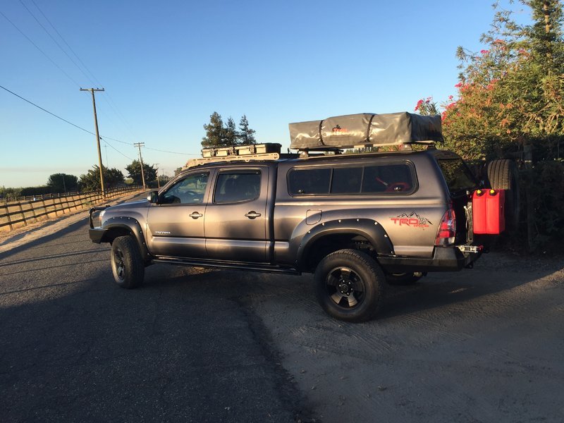

  20. Aug 3, 2016 at 9:20 AM
    TankoMyTaco
    TankoMyTaco Well-Known Member
    Feb 23, 2016
    #179167
    129
    Jeff
    San Diego
    2012 Toyota Tacoma DCLB TRD Sport 4x4
    OME Suspension:
    -887 Coils, Nitrocharger Sport Shocks, Full Dakar Leaf Pack
    = 3in of Lift (With Shell)
    -Running Icon Tubular UCA, adds for a real nice ride
    Suspension With Armor and RTT: (Sliders, ARB Front Bumper, CBI Rear Bumper, Tepui RTT)
    = Lift settled about 1-1.5in
    Tires:
    = 265/70/17 (No rub)
    (^^OME Suspension with Shell and ARB Front Bumper^^)
    (OME Suspension with Armor and RTT)
    **Tires are small, going to upgrade to some larger ones soon**
    Boonie Buster, tacoshin and TheTacoma like this.
