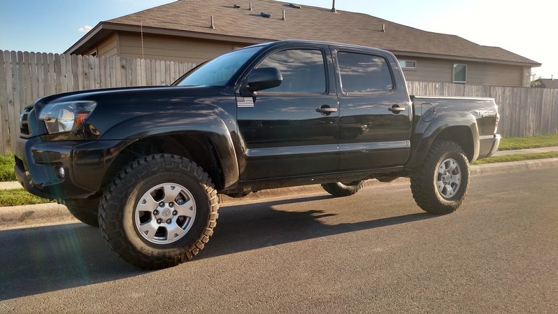

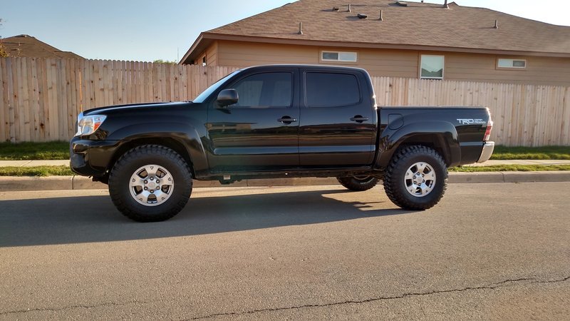

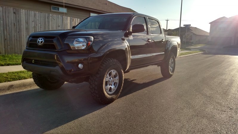

    Finally got the time to install mine the other day. Took me an hour and half to do the front without a spring compressor. Rear took about two and a half hours. Ride is nice, stiffer than the Bilstein shocks I have on my long travel XJ but it feels more stable at highway speeds, which I like. I'll be ordering some camburg uca's to perfect the alignment this week. I also decided since I do limited hauling, to see what the rear feels like after 90 days with the third leaf and the overload spring removed.
    I also did the carrier bearing drop from OME and a 3* shim from Toytec. The truck is a 6 speed manual and now it goes in and out of gear much smoother and no longer has axle wrap issues or take off vibrations. Glad I shimmed.
    90021's, 887's, Dakars, 255's, trim packer.
    No pre lift measurements.
    Post lift measurements as follows (full tank of gas).
    Tire - center of hub to fender/ground to fender
    FR - 23"/38.5"
    RR - 23.75"/39.25"
    FL - 23"/ 38.5"
    RL - 23.25"/38.5
    I hope my post will be useful to some, this thread answered a lot of my questions when I was trying to decide which lift to go with. I would also like to add that if you are considering installing this lift yourself, you should go for it. This lift is fairly easy to install and there are several walk-throughs and write-ups to be found between YouTube and a quick Google search. Good luck and have fun!
    First picture is the before, the rest are after pics.
