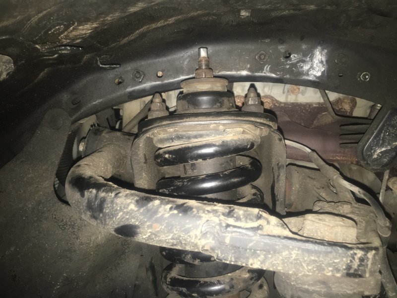

    Did you try tightening it down?

    Yeah. Couldn't get the nut to turn. Didn't want to round out the shock either. That's what makes me think it's a bushing as its tight, can't loosen or tighten it. Plus the threads showing from side to side or very similar.

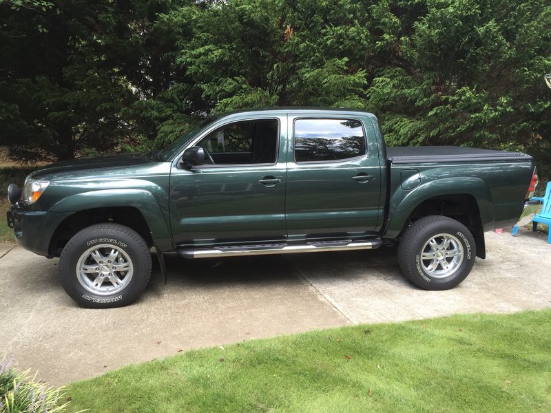

    Looks great!

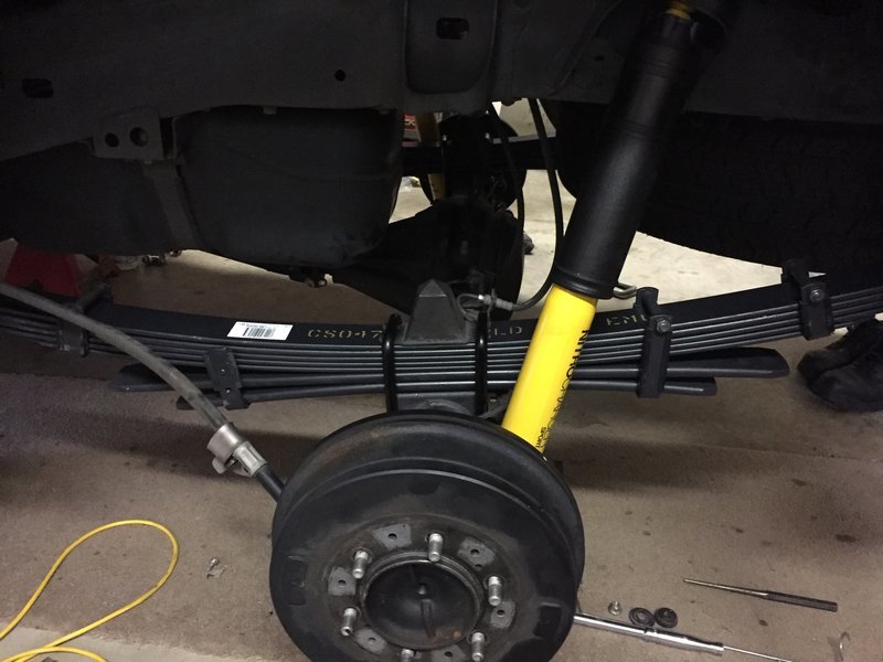

    Did you install all leaf springs or leave 3rd from the top out?

    Are you sure you have the bushing on the inside of the top hat? And I have more threads showing than you on mine so you might have more room to tighten it down. This is weird and I'm interested to see what the issue ends up being...

    From the pictures I have been seeing online there should be more threads as you mentioned. I believe they came pre assembled from toyotech but will have to double check with the shop. Been driving on it for two years and the other side is tight. Bringing it in to the shop tomorrow. If the driver side is indeed assembled wrong I will ask them to check the passenger. I'm not disassembling shocks with 886 coils.

    I installed the whole Dakar leaf pack. I gained 3 3/4" lift in the rear! I hope that it settles, and I'll re-measure after driving 100 miles.

    Went to the shop and everything is back together. Bushing were all out of whack and essentially shit wasn't tight. Hmm. Picture of it all back nice and tight. As you can see there just wasn't enough threads showing before. Now it's how it should. They had to take everything apart adjust and put it back together.
