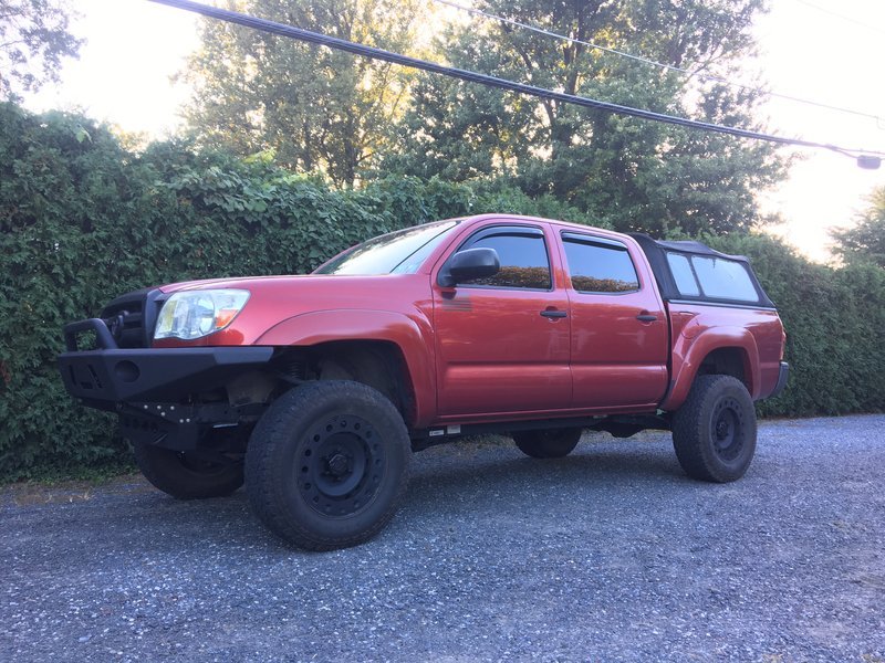

    886s on OME nitro sport fronts w/ trimpacker, Dakars and poly bushings and OME nitro rears
    Also sway bar delete
    It looks level, I didn't measure.
    Ride: way better than stock, no weight in the bed and not stiff at all. Front feels way more controlled through rough terrain without swaybar. Same amount of body roll as stock in normal driving. maybe even slightly less body roll at low speed turns, but way more body roll at high speed turns.

    ^^^Looks good Nimble9^^^
