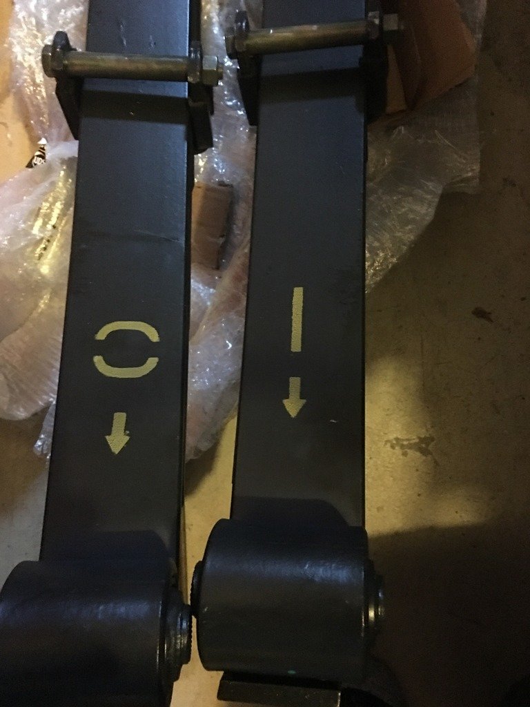

    That's a 0 (ZERO) and a - (MINUS), indicating one leaf pack is spot-on, while the other is a little weak. To not cause/exacerbate Taco lean, recommend using the 0 on your driver side and the - on your passenger side.

    Thanks guys. That makes sense. Hope I don't end up with anti- taco lean

    You shouldn't. Mine arrived the same way and, to be honest, I don't notice ANY difference in pre- and post-lift lean.

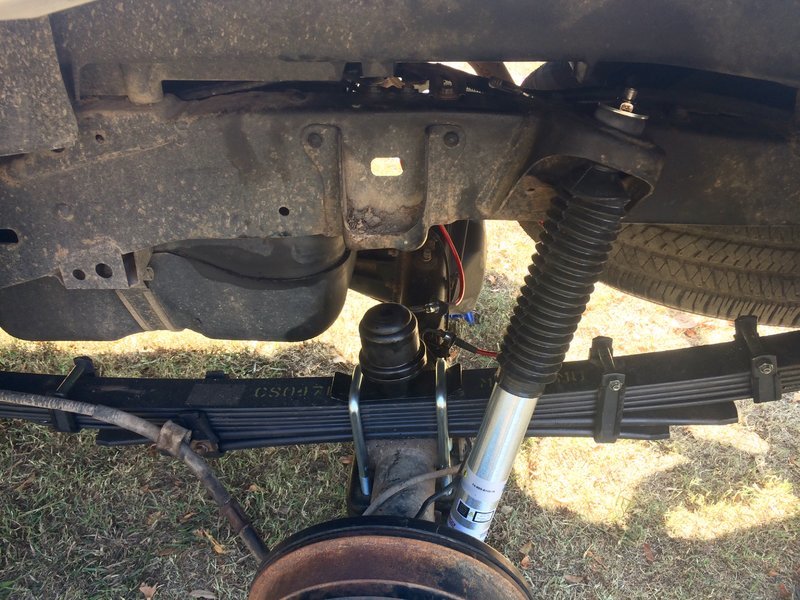

    IMG_1381.jpg To everyone that made me think it would be okay to do this by myself....die. :rofl::annoyed: Just finished the left side. Started at 1200 yesterday. That includes the new brake lines...speaking of which..I'm so angry at those little Japanese kids on the other side of the world that put the tops in a 3cm by 5 mile cave. That. Was. A. Bitch. Move.
