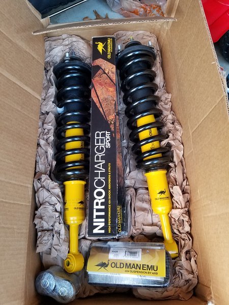

    Everything is finally in. hope to have time this weekend to install everything and get an appointment for a alignment .
