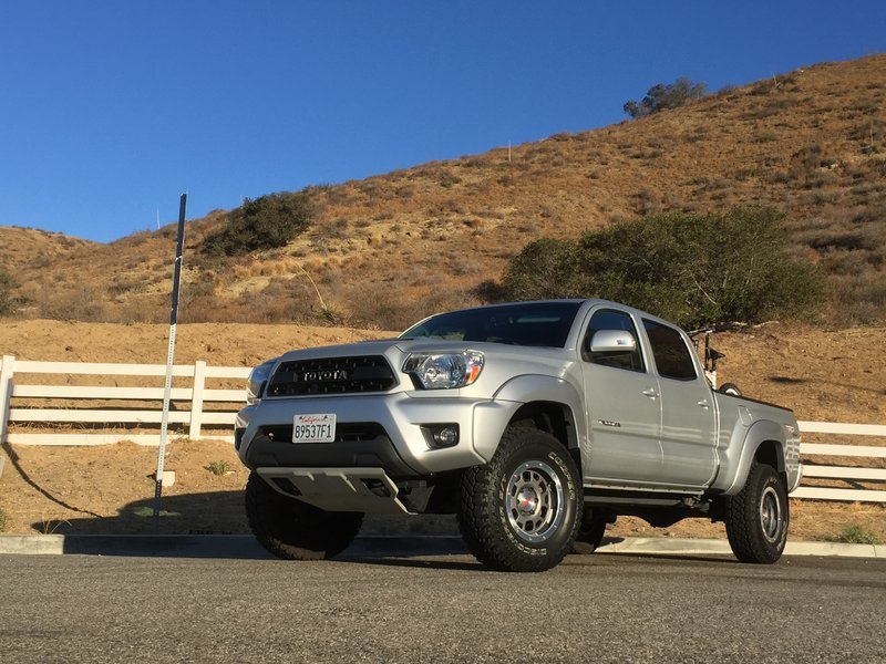

    Pretty truck!

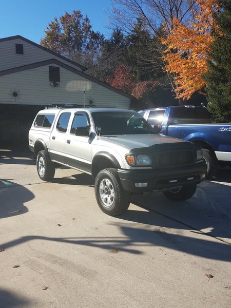

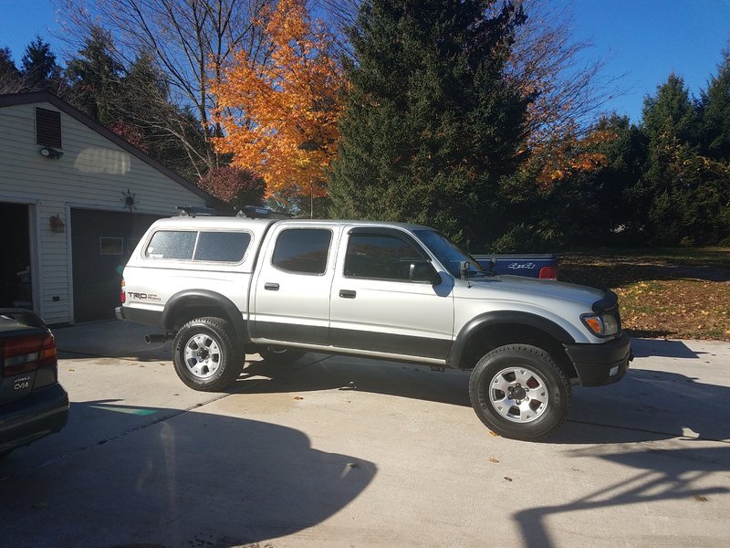

    Replace stock rear leaf packs with old man emu 2.5 inch20161104_105621.jpg 20161104_105659.jpg Leaf packs. raised the front 5100s to 2.5

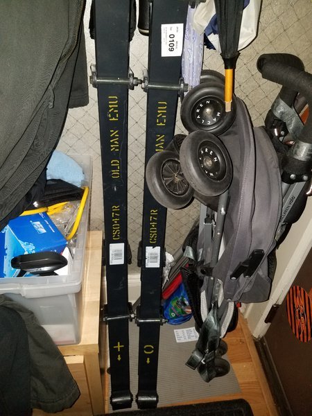

    i received my springs yesterday why does one have a + and other have () on it?

    Basically its how in spec they are. + goes on drivers side to combat the taco lean.

    + is slightly over spec; () is on spec; and a - is slightly under. Use the heavier one on the drive side. They always ship one heavier one lighter which will help with the Tacoma lean.

    Not always the case.
