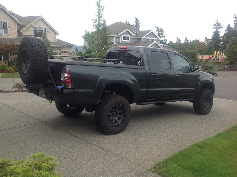

    Helped installed lift on my buddy’s 2011 OR this past Saturday. Impressed with Head Strong Offroad’s assembly of the front struts, top hats were clocked correctly for an easy install.
    Old stance - His new 265/75/16 Falken’s on 16x8 -10 Level 8 MK6 wheels were indeed too aggressive for stock suspension.
    Parts – from Head Strong Offroad
    -OME 885’s
    -Bilstein 5100’s (0 perch)
    -Head Strong ¼” top plate (driver side)
    -Deaver AAL
    -2.5* shim
    Didn’t install
    -Carrier drop
    -Rear Brake line bracket
    New stance
    Will get it aligned shortly and confirm if the OEM UCA's will deem acceptable or not. He has reported it rides great and is pleased with the look.
    Question to those out there with similar setups with the Deaver AAL... if we were to remove the overload, what amount of drop should we expect? He may want to get it to sit with less rake. - Thank you

    The drop would be the thickness of the overload.

    Thanks, that is my thought too. But thought maybe it did provide some suspension/lift to the leaf pack
