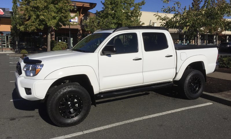

    OME 885 coils, Dakar leaf pack, Bilstein 5100 struts, SCS Matte Jet Black SR8 wheels, 265/75/16 Toyo Open Country AT II, Arrow cap, Truxedo Truxsport Tonneau cover, TRD Exhaust, colour matched grill.

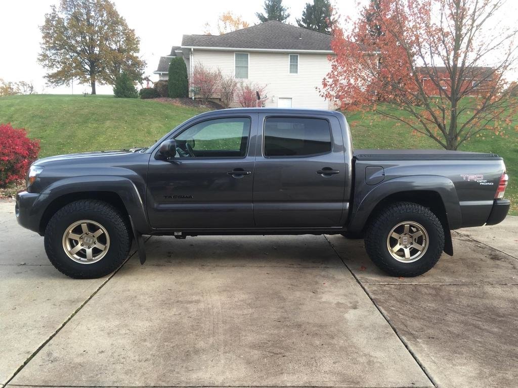

    Here's mine with OME 885 front and Dakars in the rear. Bilstein 5100 on all four corners. I will eventually get a set of 887 coils to lift the front a little higher, a little too much rake for me.

    Thanks for the info! Seeing that I have an access cab though, I may stick with the 885's because I know my truck weighs just a little less up front and will see a little more lift (likely) from the 885's than your double cab. It looks awesome though!
