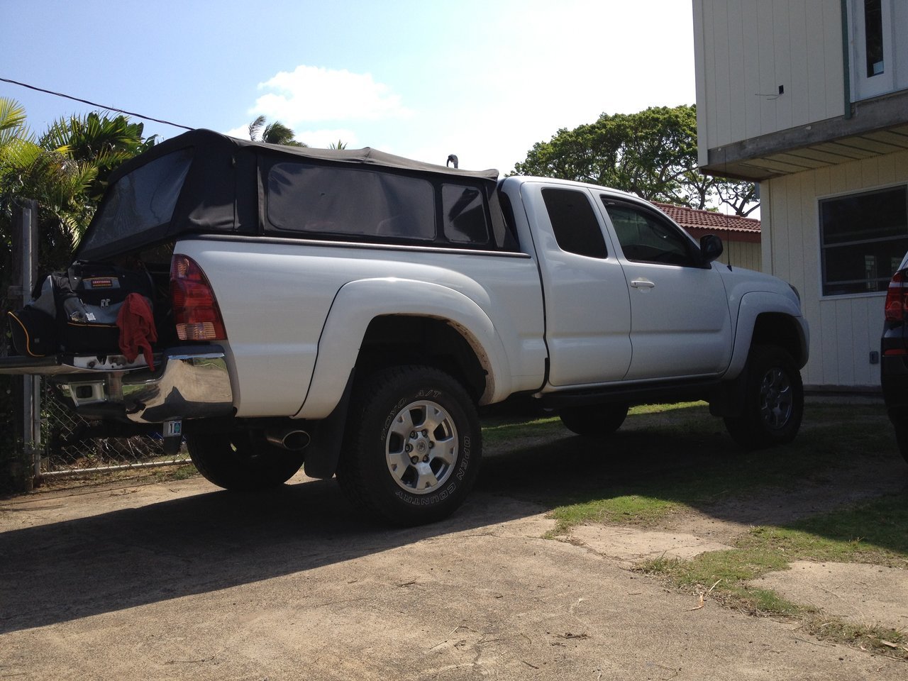

    What did you put up front & what did you get?
    886x+90000 nitrochargers + driver side 5mm trim packer
    What did you put in back & what did you get?
    Dakars+AAL, sitting roughly at 25 1/8 with a soft top,tailgate reinforcement and tools
    If you got Dakars on a 2nd Gen share your measurements with OZ 2nd Gen
    OME Dakar hub to fender measurements ( 1 2 3 ... Last Page)
    yup
    Are you running trail armor & how much lift did you loose or what did you do to regain/maintain lift?
    just oem skids till BAMF armor arrives
    Tire & wheel specs & rub or what you did to eliminate rub.
    stock sized 265/70/16 Toyo open country AT2, no rub
    Are you still running a sway bar?
    yes, no relocate, no rub so far(on-road driving)

    How about some pics Mike? The only thing better than Taco porn is Emu Taco porn.

    I'll try and get some action shots this week
    * that tool bag on the tailgate weighs almost 80lbs :D
