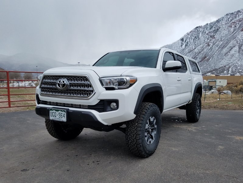

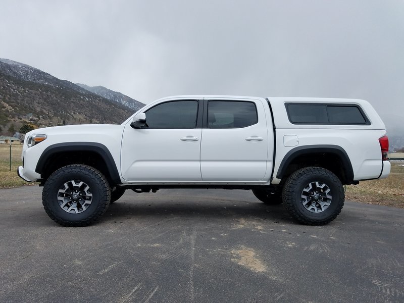

    image.jpg image.jpg Wife was complaining about not being able to see over snow banks at intersections. This should help with that. OME medium kit. Love the stance and ride.
    • 2888 - Old Man Emu Coil Spring
    • 90021 - Front Old Man Emu Nitrocharger Sport Struts
    • CS047R - Rear Old Man Emu Leaf Springs
    • 60091 - Rear Old Man Emu Nitrocharger Sport Shocks
    • OME95PF5 - Old Man Emu 5mm Trim Packer
    • SPC -upper control arms
    • ECGS- clamshell bushing
    • Headstrong 1/4" driver side spacer
    • 285/75/16 BFG's

    Love the look of your truck! This is the kit I'm looking into as well. On their site it says that the medium kit is best suited for trucks with an aftermarket bumper, did you have any issues since you're running the stock bumper? I've got plans down the road to get a Pelfreybilt but that's going to be a while.

    No issues whatsoever. I wanted to have 1"rake with the topper on. The 888s height numbers worked perfect to match the rear Dakars for the stance I was going for. Rides really good.
    Please note I forgot to add the wheel spacers to my list above. No cutting and no rubbing daily driving. Still too much snow where I live to stretch it's legs Offroad.
    WZ

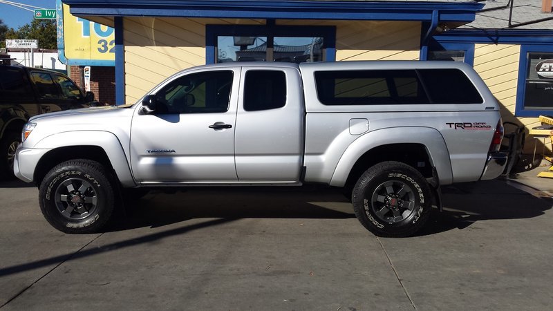

    Depends on your application... I'm running 885s and Dakars. I have some rake even after removing the second overload leaf from the Dakars and installing a topper.
    You have a DCLB, which is a little heavier than my Access Cab, so YMMV.
