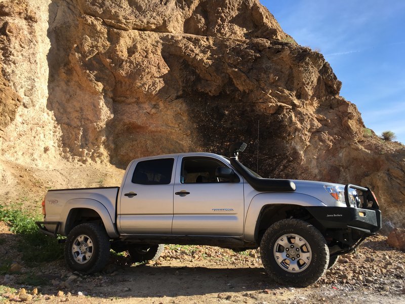

    884s paired with 5100s and an AAL should get you to right around the 2" mark. Let me find a picture of when I had that setup.

    I'm at 23-5/8 up front and 24-1/2 at the rear from center of hub to fender flair. It's definitely noticeable especially with the 285s. I didn't take stock height measurements.MPGs are around 18 or so. And that's at 6000'to 8000' elev.

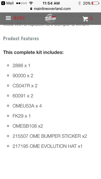

    Picked up the OME 2" Heavy Sport suspension kit, I'm a big fan though I'm concerned about trying to fit 285/75r16
