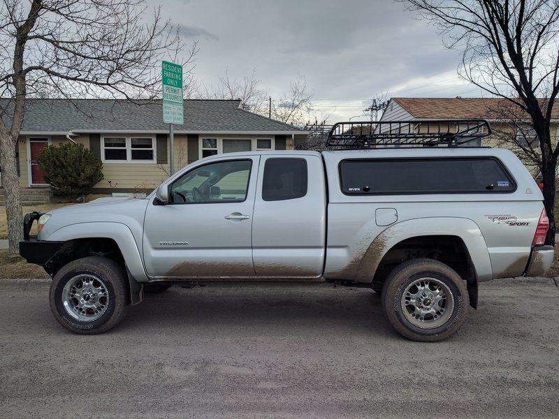

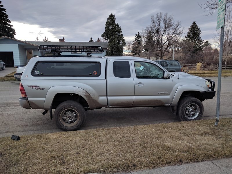

  20. Mar 18, 2017 at 3:52 PM
    schnob
    schnob Well-Known Member
    Oct 17, 2016
    #199992
    54
    Sebastian
    2005 Silver Tacoma, TRD Sport, Access Cab
    ARB bumper with fogs, OME heavy lift kit
    My taco is a 2005 Access Cab, 4x4 TRD Sport. I am still running the stock UCAs.
    I put 90000s with 886 coils up front with the trim packer, got about 2.5 inches on both sides.
    60091s with the full CS047R Dakar Leaf pack in the back, got about 2.5 inches on both sides as well.
    Put my ARB bumper on at the same time.
    Still running stock tire size, 265/65/r17, definitely gonna have to size up in the near future though.
    I am still running my sway bar.
    Digging the ride quality and appearance so far, can't wait to get it on some country roads.
