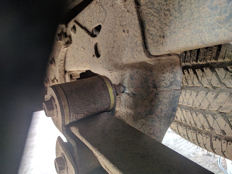

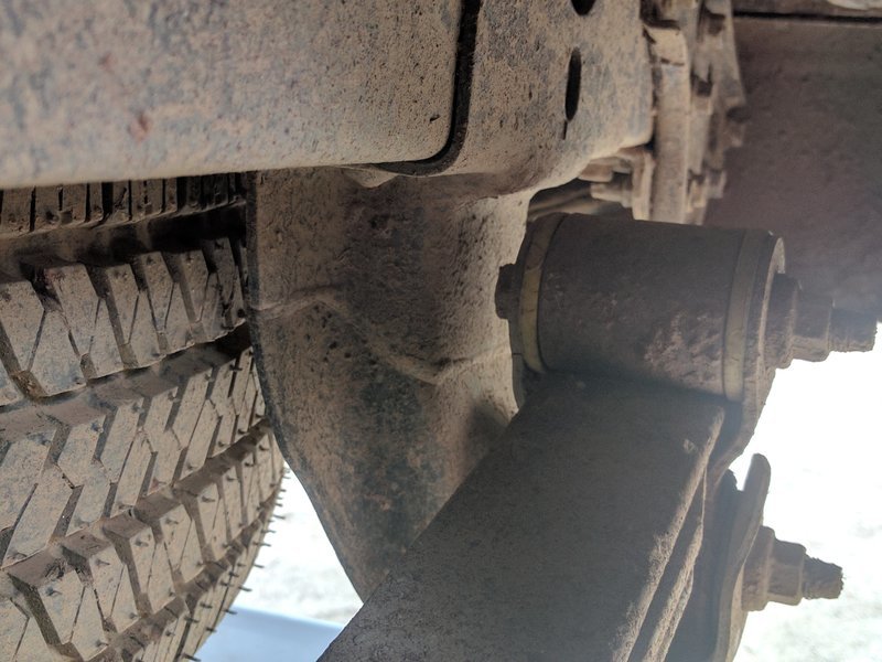

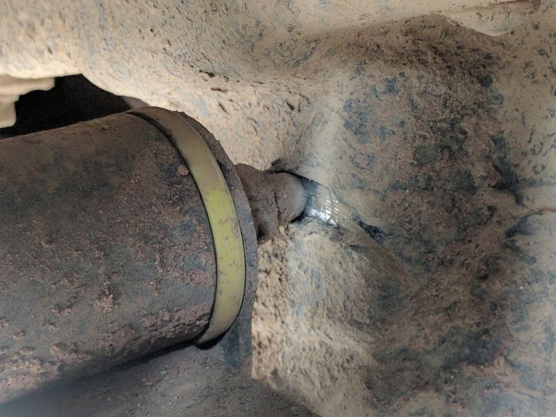

    So I had the OME heavy kit installed a few weeks ago and I just recently noticed that one of the bolts for my dakars is too long or something is doing a number on its hanger. IMG_20170417_172416.jpg IMG_20170417_172421.jpgThis is on the passenger's side, on the driver's side it's fine. IMG_20170417_172446.jpgWhat should be done? Could I cut down it down? Yes, I know my truck could use a wash, haha.

    flip the bolt?

    I figured it might be that simple, call me what you will for not doing the installation myself but I feel like must have been a reason for the shop to have the bolt facing that way? Seems like it would have been obvious that it would rub that badly.

    Ouch! That shackle needs to be able to move in accordance with the load placed on the springs so perhaps a shorter bolt or bend the frame away some. Odd that this is just happening after the install of Dakars and wasn't happening with your OEM leafs o_O

    The dipshits put it in backwards. Either take it out and flip it (at which point you have completed 50% of lifting the rear yourself) or cut it off.
    This is why I do my own shit.

    Ah, yes I see that now. Had to go out to my truck to compare :anonymous:

    That's disappointing. One would think they would have noticed during the installation. I guess flipping the bolts on that side would be the best solution then. Should I consider this pretty high priority? I'm kinda living out of my truck at the moment and don't have anywhere to work on it. It seems like the damage has been done.

    Find someone with a reciprocating saw and lop it off. Got and friends with power tools? Where you at? You can come use mine.

    Haha, I appreciate the offer, I'm in Bend, Oregon. I have a slow power steering leak the dealership couldn't diagnose that I'm gonna get checked out by someone else on Friday so I'll just have them flip the bolts.
